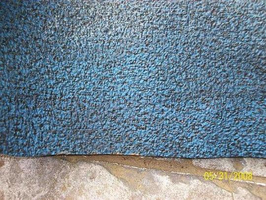

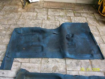

OK,here are some of the pictures of the mat.

I will have more later, but you understand the general idea of what I am dealing with...

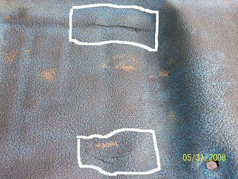

More pics.

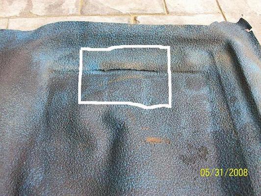

more

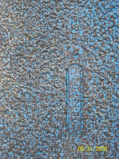

Part numbers

The paint on the mat is like a grain affect. Can anyone reproduce that?

Start glue-in! The 'grain effect' is actually the blue paint that has worn off of the high spots of the rubber textured mat. All ya gotta do is spray it blue again, after ya fix those holes.

I remember a cheesey TV commercial for a product I bought that used to air here during the 1970's,similar to a K-Tel/Ronco type product that would show them repairing rips in vinyl tops,luggage etc.It worked pretty well for me.
It came with multiple cups of different colored gummy compounds to apply with a spatula & match to the tear,rip or hole you wanted to fix.
After application to the tear,you would let it set up and then choose from one of the many different madrid/pebble grained vinyl textured patterned pieces of paper they supplied and lay it over the repaired area to heat with a household iron.After cooling down,you would pull the paper off and see a final vinyl repair that closely matched in both color & texture.
Here is a Permatex products page showing items #80902,81781,81785 and 81786 that look like the same idea to me.
Scroll down to the bottom for prices..
http://www.caswellplating.com/permat...pairprods.html

[/ QUOTE ] M, if you look at my pics of the part numbers, it looks almost like it's not worn high spots but like a burlap was layed over top of it and then sprayed?
