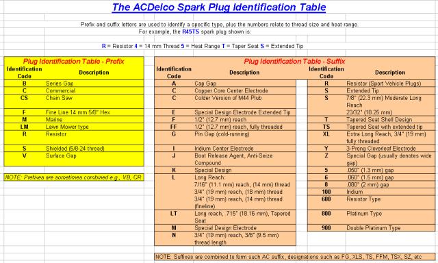

I thought I had an NGK cross ref - but I can't find it. This might help though - you can cross ref your AC to Champion, then back check the Champion number to NGK.
