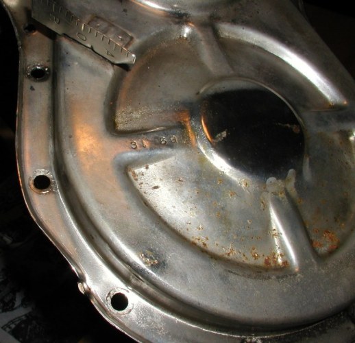

I have an 8" timing chain cover that was chromed that is dated 31 69. Is there a way to get the chrome off with out messing up the timing cover or just paint over the chrome? Also does the 31 69 mean that it was made the 31st day of 1969 or is it march 1st 1969???

Take it to a chrome plater and have them de-plate it.It only cost a few dollars,at least here it does,and you can even wait for it.
...31st day of 1969.

Its Thirty first day of the month 1969, not a month and day code..best to replace it but you can also sand blast the heck out of it and paint it as a backup plan,it wont hold paint as long though

mr70 is right about de-plating the chrome cover; the plater will chrome strip it, leaving the nickel and copper.
After it's chrome stripped, bead blast it, epoxy prime and then paint for good results. I did this to the rear bumper of my El Camino SS about 20 years ago (when the painted-bumper look was in) and the paint is still in good shape today.

Sorry for taking a while to answer but I have been busy. The timing cover I have isn't for sale although it sounded like it was. I was just trying to find out if I could get the chrome off to try and save it. Sorry for any confusion. It probably isn't in as good of condition that you would like it anyways.
I am adding an attachment of what it looks like. I have not figured out how to get the picture to come up without having to click on the attachment above the post.
