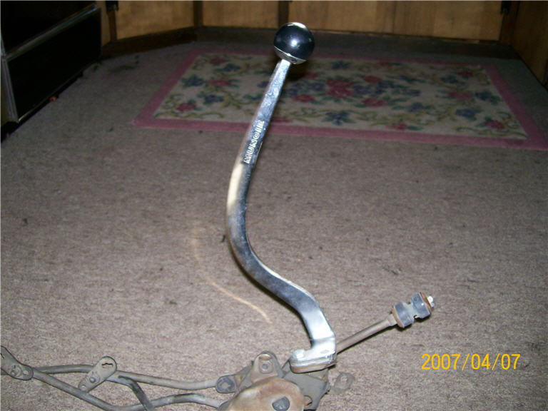

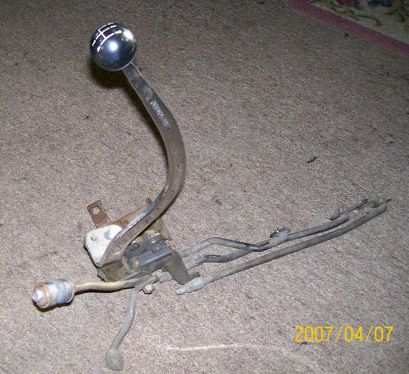

Here is a 69 fullsize shifter Rainer had for sale.Handle is console shift but the rest is correct for the biscayne
This will show you the differences.

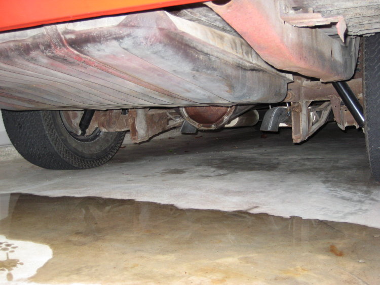

more

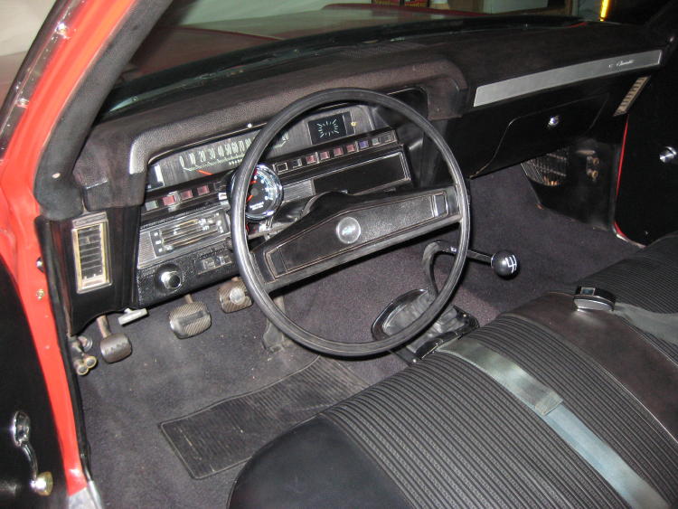

interior

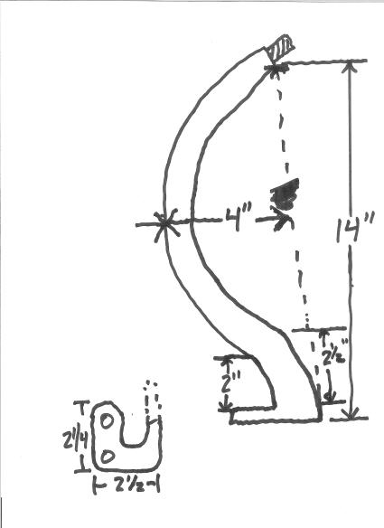

Here's a layout (my feeble attempt at drawing ) of the dimensions of the Muncie shifter from my '68 Biscayne.

A couple more. Note: the "bend" doesn't look quite as severe.
