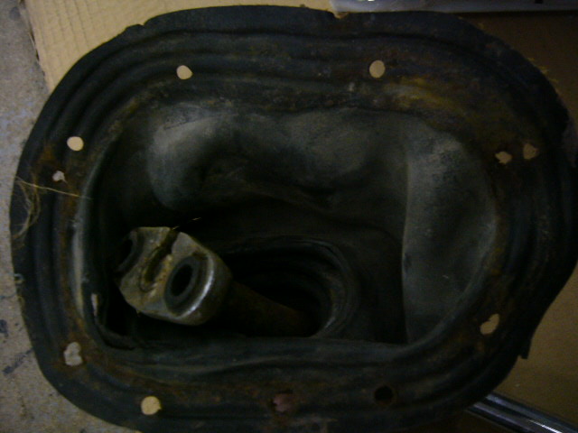

Here is a few pics of a orig correct 67 bench seat chevelle/big car boot,notice how rounded it is overall top and bottom vs the earlier 65/66 big car squared off one ,also how on the earlier one the shifter exits farther forward than the 67 chevelle one...The 67 boots seem by far more scarce i have not found a single one yet and have been using the 65/66 ones to get by...

Default Re: Top $$$ paid 67 bench seat shift boot..
bottom

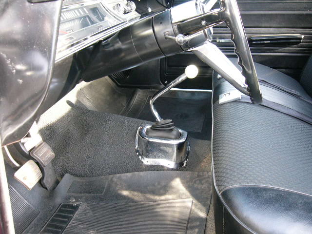

here is a 65/66 boot in my 67 and it looks the part once u get the bezel on..

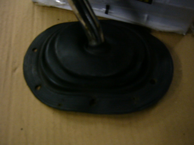

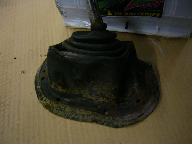

I wish I could see the differences but the pictures like mine are dark and hard to see.
This is a 66 chevelle boot that I sold complete with the shifter out of a 66 chevelle. It was original in the car.Do you agree this is 66 chevelle
Now this is a 67 Chevy 2 bench seat boot and shifter I sold which looks a lot like the one you are saying is 65/66 fullsize only. I wish my pictures were clearer
Now here is the kicker. According to my fullsize parts book the boot or seal for manual trans control lever as they call it is part number 3860183 which is what I show in my original picture and the parts book says it is the same for all 65-67 fullsize with a bench seat.
check out the side view of my 1st pic look how high the side of the boot is to cover the hole and still fill up the bezel area.Your boot is short and low to the floor i dont think its a 66 chevelle non console boot as they were more oval and had a oval retainer with a colored plastic garnish ring not squared off like the bottom of yours...
