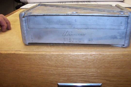

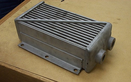

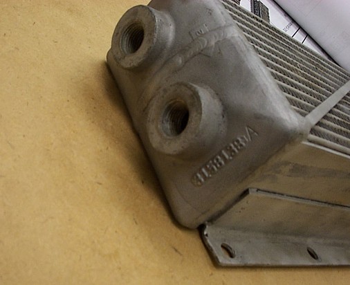

Interested if anyone has info/photos of any factory/dealer installed external oil coolers utilizing the dedicated tapped/threaded holes in the area of the oil galley. If none available from factory/dealer, what were most folks running for street/strip duty? Where did they mount the cooler?
Thanks,
Sam...

I had saved pictures of an NOS GM cooler on eBay several years ago. I'll see if I can find them. It seems like it would have been mounted in front of the radiator for maximum cooling

seen quite a few harrisons on T/A small blocks mounted on the left hand side of the rad support.

Is that a reference to "harrison" external cooler?

MYSTERYCHEVELLE MYSTERYCHEVELLE is offline
Join Date: Jun 2002
Location: Jeffersonville, PA
Posts: 1,106
Thanks: 263
Thanked 406 Times in 194 Posts
Default Re: External Oil Cooler-4 bolt BB Chevys
Sam
I have great pics of one that I just looked at last week... HARRISON is on it.. Unfortunately my home computer is getting a tune up, so I have not been able to download the pics I took of it.. but it is Primo!! Cool item
