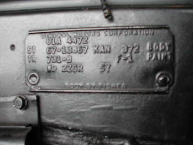

I would like to see a pic of the cowl tag?? That will give the trans info.

Cowl tag is pictured in the auction. Trans info???

Thats probably me that started that Mike..I looked at the trim tag and seen 2zg and do not see the 2L that should be there for 4 speed. I thought z and m were codes for automatics. Whats your take? Ive never seen a 2Z 4 speed code. HERES THE TAG

Group 2 with an "M" is definitely an automatic. But for 66 and 67 Chevelles, I do not know that "Z" represents an automatic...
