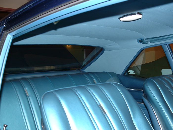

And here's Ray's car. I zoomed this from a larger picture so the quality isn't the best, but you can tell the piece in question is in fact <font color="blue">Blue. </font>

I hand sanded with 600 grit and only find black. I used stripper in A couple of areas and it didn't reveal any blue at all. Thats odd because my package tray area cleary has the same blue paint on it that the dash and portions of the doors have on them . I'll sand more this weekend but I think my car is supposed to be black at the base of the rear window. The only other thing I need to find out now is where does blue paint stop at door frame and doors and where does the black exterior start???

Before I looked at mine, I was going to throw in the towel and say I might be wrong. Tommy, the black starts about 1-2 inches in a straight line, all the way across the package tray area, in the back, and goes up onto where the back glass sets.
Again, mine is a cheapo bench seat interior, where Ray's, and Tommy K's are deluxe.
Havn't had a chance to check out Jon's yet. Seems like there is no rule of thumb when it comes to 68's

I've been doing some checking on this color vrs black issue. Looked at a 70 nova today at a car show. It was gold, with a gold dash, and the rear window support was interior gold also. Talked to Cronkleton today. His red 68 L78 has a black interior, with the window support black. My thought is this. If your car came with colored seats, the interior, including dash area, and rear window support were most likley interior body color. If your seats were black, the dash area, and rear window support area were black. Ray, and Tommy K's gibb cars have color seats therefore they have body color window supports. My 68, and Cronkletons have black seats, so they have black rear window supports. If your car had colored seats, and headliner, that back panel should be interior body color. Black seats, and headliner, black window support.
Greg, please also do some checking, but this is what I've found so far.
