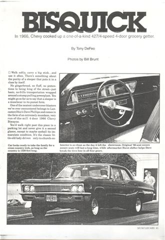

In Musclecars they called the quick 4-door Biscayne "Bisquick".
