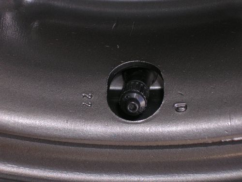

I know this has been talked about in the past but I couldn't find the right post. On the Nasty site they say DDl 32961 but that seems to fade after a while according to people that have experience with it. What would you 2nd gen guys recommend. Also I need 4 GoodYear Poly Glass GT F-60 15's, who got um? Thanks.
Attachments - The Supercar Registry 199954-tn_DSCN1777.JPG 199953-tn_DSCN1776.JPG 199952-tn_DSCN1775.JPG

Read THIS Link............
https://www.yenko.net/ubbthreads/showflat...true#Post198027
You can either use the correct paint formula and have your wheels look original......or you can use a vast variety of other paint products or even powder coating.
I had a 70 Z-28 new, and I can recall the original paint degrading from using a scrub brush to wash/clean.
Bottom line is correct/original or Plan B/durability

I've done several sets of these wheels with DDL 32961 with great results. It's the only paint that give the correct look and finish. Not sure how it holds up in, but the way we use and drive these cars, I think it will last a long time.

What paint and color is used on the inside of the wheels?

PPG 35517 in DAU same as jack base and jack mechanism
