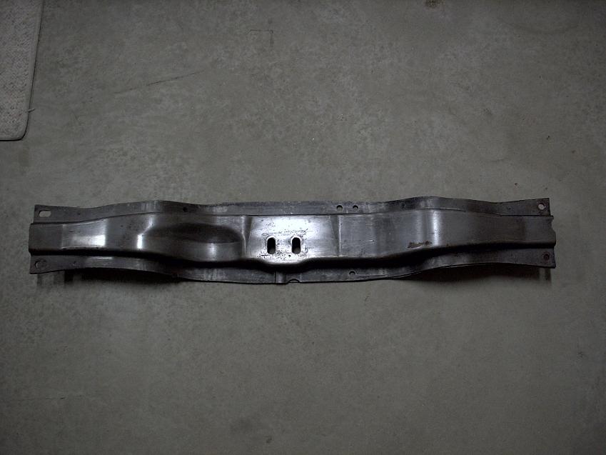

I have a 68 Camaro that I put a BB 427 in last year.The car was a roller but the previous owner had a BB 454 in it. My question is I was told that the crossmember under the transmission is a small block one because of the oval opening instead of the well known square type. The holes are offset to the passenger side in the oval opening instead of being centered in the opening. I just talked to a restoration parts person who said that he has seen GM numbered crossmembers with the oval opening. Has anyone else seen this? I used the BB motor mounts and didn't have much trouble bolting up. Is it possible to even bolt up correctly if I'm using the wrong crossmember?

Good question. I've seen plenty of fake BB 69 Camaros with
the oval hole X-member. However, every real BB 4-speed I
have ever seen has the squared-off hole.
I actually never did get a real good answer as to why the
BB 4-speed X-member exists anyway. Aside from the hole
difference, and the large dimple on the upper passenger
side, they appear to be the same. What is the actual
positional difference of the transmission in conjunction
with each of these X-members? Surely someone here used a
SB X-member on a Camaro once.

If you use small black frame and motor mounts. The small block cross member works fine. If you swith to big block fram mounts. The motor moves up and over to pass side. Then you will need a big block cross member to line up trans mount. I found out the hard way. Earl

Steve, I'm not really concerned if the crossmember is original GM although the guy I talked to said that he has seen them with GM numbers on them as much as I just want to make sure that it is a BB Xmember. Were the oval hole ones that you have seen aftermarket ones? This one has the original holes (slots) in it with no other holes so it isn't modified. Does anyone know if the holes in a SB Xmember centered in the oval opening? These holes in mine are about 1/2"-3/4" offset to the right like a BB should be. This crossmember has been in the car at least 17 years or more so I can't picture anyone having an aftermarket one out then since most of this aftermarket Phenomenon as being more current. In fact, I don't even recall anyone manufacturing a BB 4 speed Xmember at the present. I may be wrong.

The only BB 4-speed X-members I've seen have the square hole/diagonal cut and the offset trans mount holes. Earl explained the reason for the offset on the mount holes. Attached is a topside pic of a Camaro BB unit. I believe Heart Beat City reproduces these.
Can you post pics of the top & bottom side of the one you have?
Darrell,
To help, see if you can get the engine frame mount part
numbers. These are stamped on the flange surface between
the upper two bolt holes. If big block mounts, then you
need the BB X-member. Again, repro's are on eBay.
Steve
