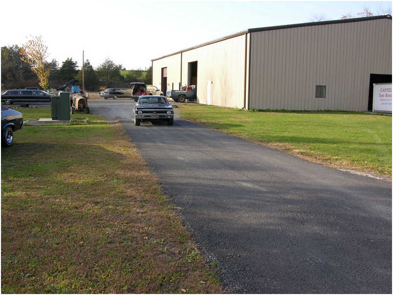

Are you ready to come and meet Pete? Just finished a nasty LS6 motor for my buddies 70 chevelle. That will run real good on the street.
