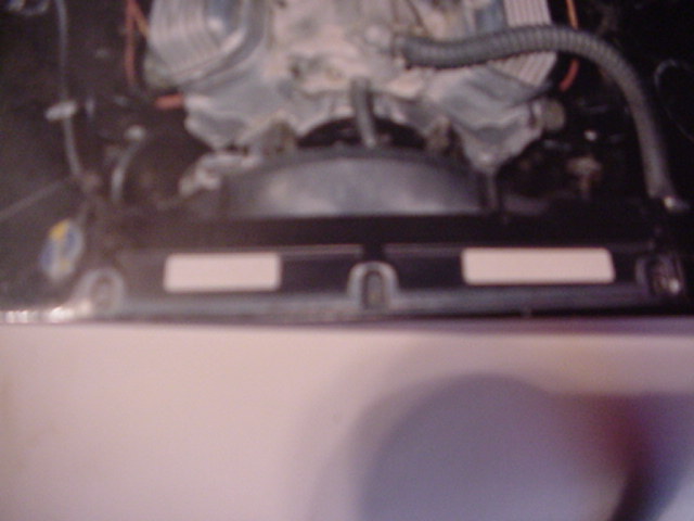

Enclosed is org picture of my car taken 1970 Notice the plate and shroud.I think they are different than the v8 plate and shrould. I have the org. plate on my car and the part # stamped in it is the same as the VO1 # 3973904 This what I am looking for. Kim P.S. my car was a 6cyl. to start with.

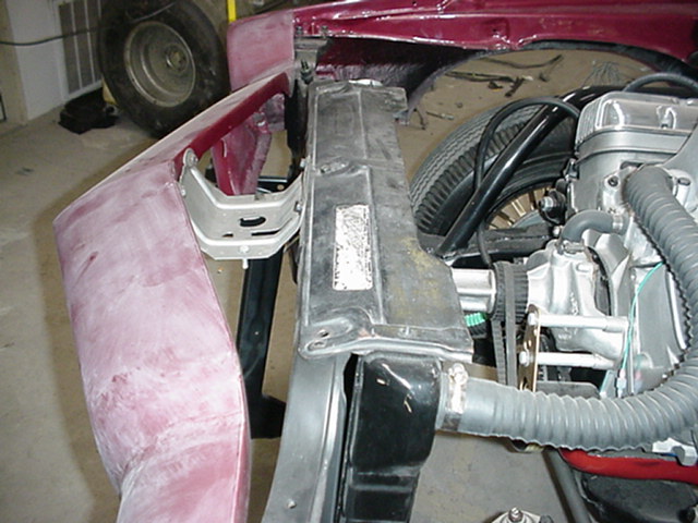

Default Re: '70 Camaro Fan Shroud
Same plate 35 years later!!!

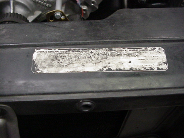

org. sticker 35 years later

The 6 cylinder and non-AC cars had the smaller top panel and shroud as shown in your picture.

Kim after looking at your picture you need the 2 piece 912 and 910 shroud. If you are not looking for original you can get the 2 shroud pieces through GM. Approx $45.00 each piece.
