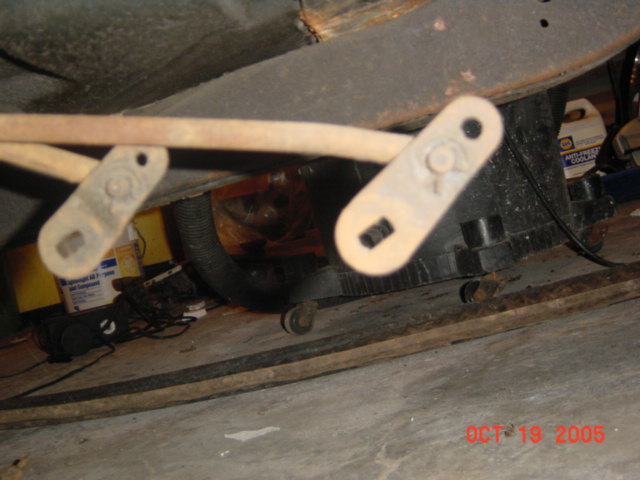

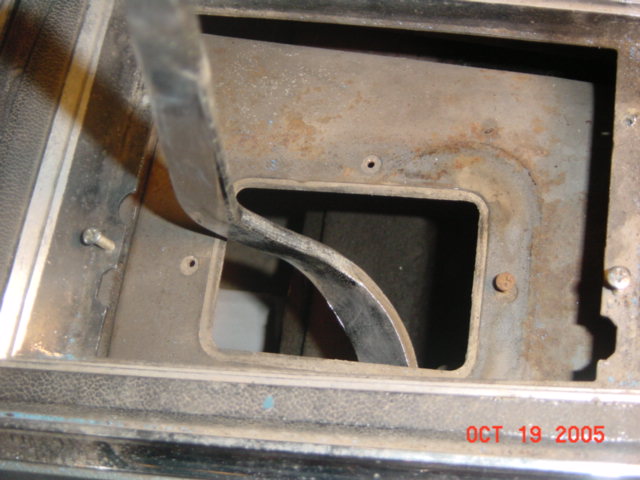

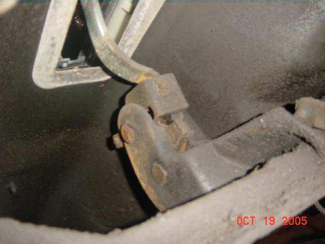

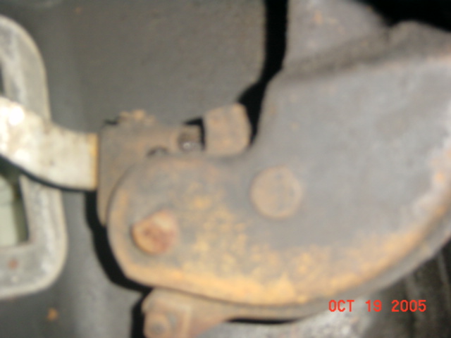

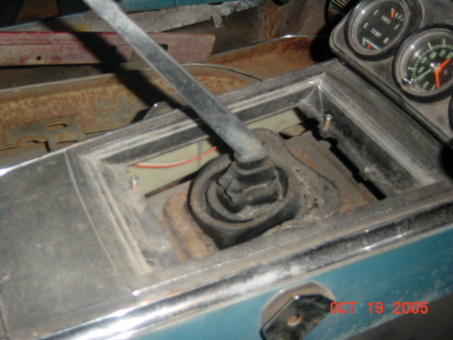

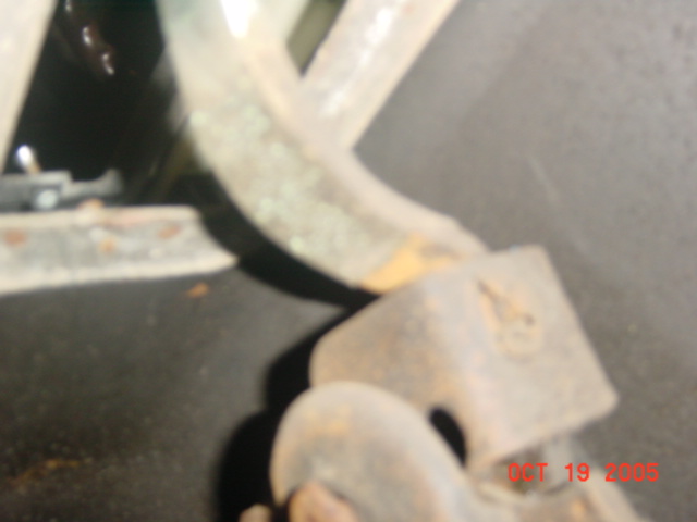

Here are the pics of the shifter in my 67 z/28. It doesnt appear to have ever been out of the car, but who knows. This car was drag raced and it is very possible it could have been changed out. Take a look and tell me what you think. I couldnt find any stampings.
