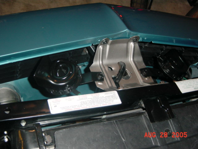

one more

last one

Jonesy, Thanks for your answer "On page 156 of the 1969 Camaro Factory Assembly Manual, UPC 12, Sheet A5 it shows the horns facing what would APPEAR to be REARWARD."
and then you other responses whereas your 69 Camaro has them facing FORWARD...........

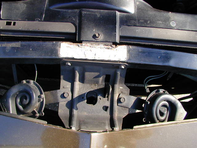

Here's my addition to the post. This is from my former LA built Z28. I am very sure these are the way the factory put them on. I have seen them turned the other way. From what I recollect, the horns were mounted rearward to keep water from entering.

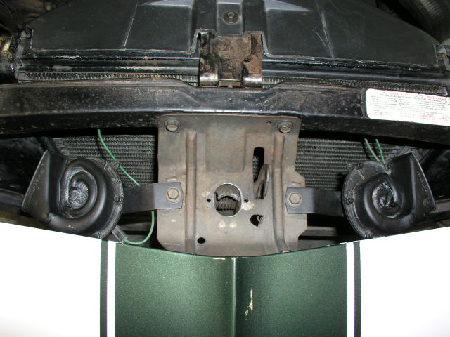

Chuck, Here is the correct way and hopefully a better pic for you to understand.
