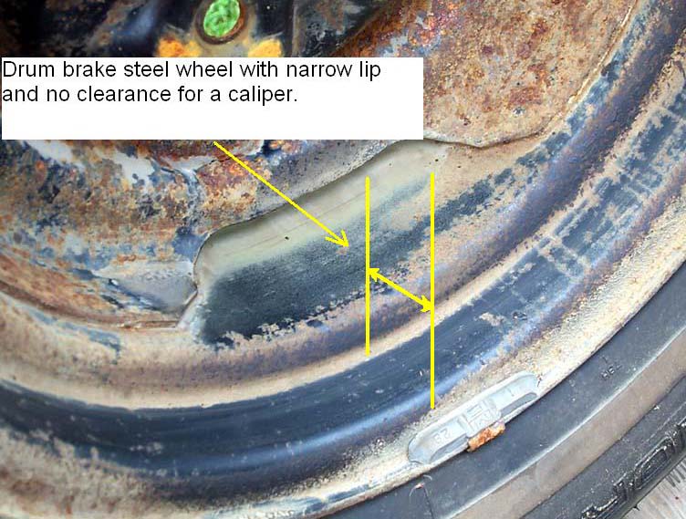

Here is the FC coded 14 x 6 steel wheel for drum brake 68-69 Camaros. Notice how narrow the lip is on the backside of the wheel. This will interfere with the caliper on a disc brake car. I will post a picture of a disc brake wheel in a little while.........RatPack.....................

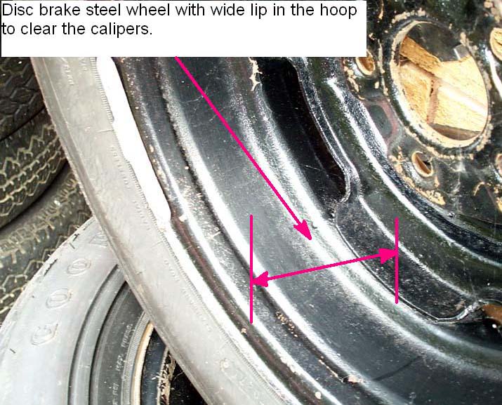

Here is a picture of the XF coded wheel showing the clearance for the caliper on a disc brake car. Note how much wider the "lip" is compared to the FC wheel...........RatPack.........

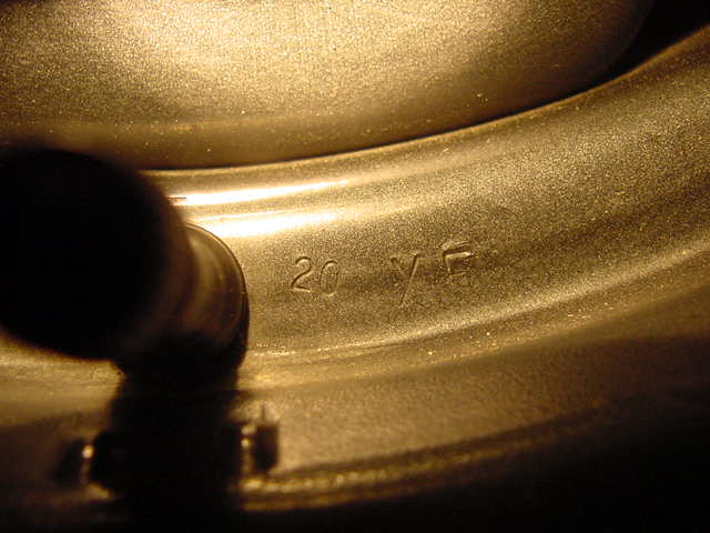

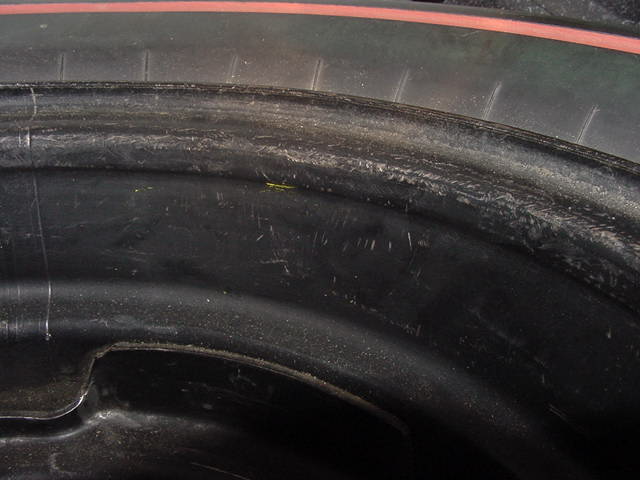

I think mine look a little different,they are smooth up to the ridge.
Les Dixon 68 camaro SS 396 RS convertible L34/M40/G80/U69

Default Re: unusual 1969 Camaro with dealer installed sunroof
pic 2

Am i seeing things or do you have the redlines mounted inside-out?

you have a good eye.That is the original us rubber tiger paw.the original owner didn't like the red stripe so he turned them to black walls.I remember my uncle had a new 65 442 and he did the same thing.
mr396, thanks for posting your wheel as you are right. I took the picture of the back of my XT wheels as I didn't pay much attention to which one I grabbed out of my stash, I just saw the X stamped on the front and didn't look at it too close. But you can see the differences between the disc brake wheels and non disc brake wheels. This also applies to the rally wheels in the 14" diameter. I am still researching whether there different "hoops" used on the 15" diameter wheels for drums versus the disc applications. So far I have not seen the same scenario with the 15" wheels I have here as all of them have an inside diameter of 13-3/16" at the smallest point no matter the application. Offsets are the main differences......................RatPack.......... ..
As for the writing and lines on the pictures I used my "paint" program which is on most computers with MS software...............RatPack.................
