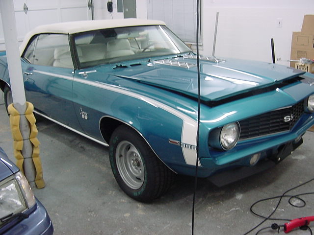

What it is or isn't; documentation or not; priced too high or not; that's between the seller and any possible purchaser. That's all irrelevant to me since I'm not in the market for a car in this price range.
I would just like to say the car IS GORGEOUS in Fathom Green and White which has always been one of my favorite color combos for 69. Unfortunately I couldn't wait for my dial-up to load all the pictures. About the only thing I might have done is to put the correct "era 69" tires on. Good luck with the sale.

No doubt its a nice car, I don't think anyone is arguing that at all...nor the price, etc... just wondered why no documents have been shown or mentioned, as that would seem to be the only way to verify the car as being legitimate L89. I agree with the tires, as well as a few other small details... overall a nice looking car....Paint those silver headlight buckets black.

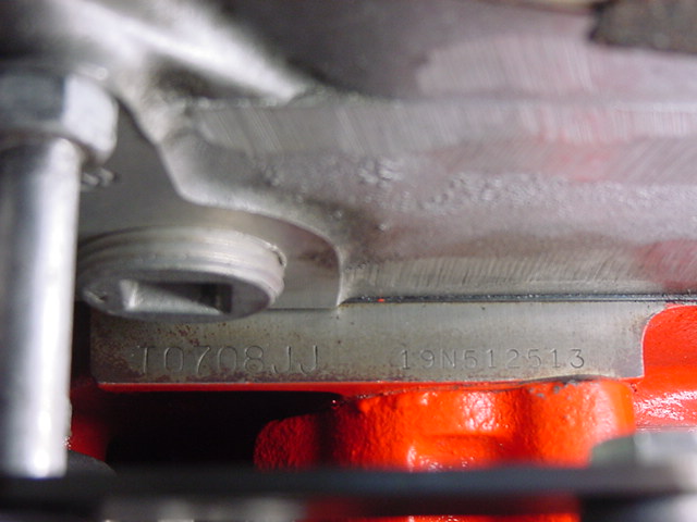

Jerry,
I agree with the characters in the vin stamp on the block. I have never seen the "1" in the vin # have the feet on the bottom. Also what is your opinion on the essembly date on the block so far from the build date of the car. That is about 10 weeks apart. I hope people do their homework on LARGE purchases like this car. The "MOF"
"POTTER BROS. SUPERCARS"
72 Nova SS "My first car of 30yrs"
70 LS-6 Chevelle Double Blk 30k survivor

Broaching on Engine Stamp Pad appears correct and distinct. Are there still machines out there today to produce this type of machining marks?
SAm
Sam...
