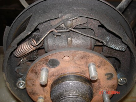

Change the rubber line at the frame to caliper/cylinder.It is not releasing.......

Steve: Yep, I'm gonna' replace the hoses (and the cylinders and the springs and adjusters, etc.). The more I read from y'all the more it sounds like the line swelled and wasn't allowing the brake to release.

Looks like a leaking wheel cylinder was causing the right front to lock-up. I'm thinking of getting the rebuild kit from PST that has metallic linings, new wheel cylinders, hoses, springs, etc. Anyone have experience with PST?
