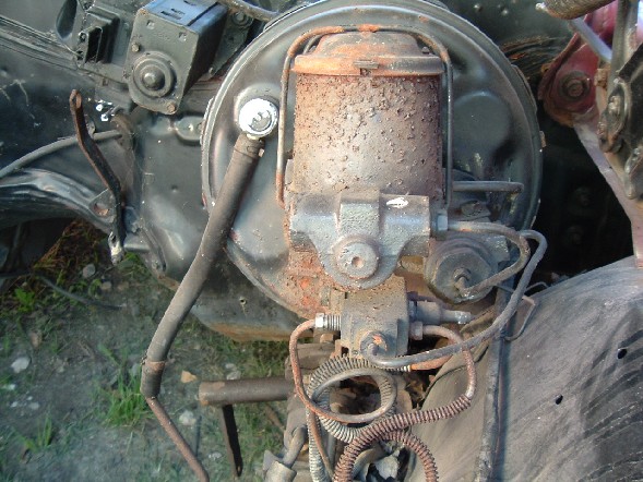

shot of brake booster and part of firewall...

Looks like the throttle arm has the cowl induction solenoid bracket on it.

I was told that the little hole that you see under the brake booster where the gas pedal would be is the hole for the wiring for the cowl hood set up. My friend that found the car said it also had a single fuel line.
