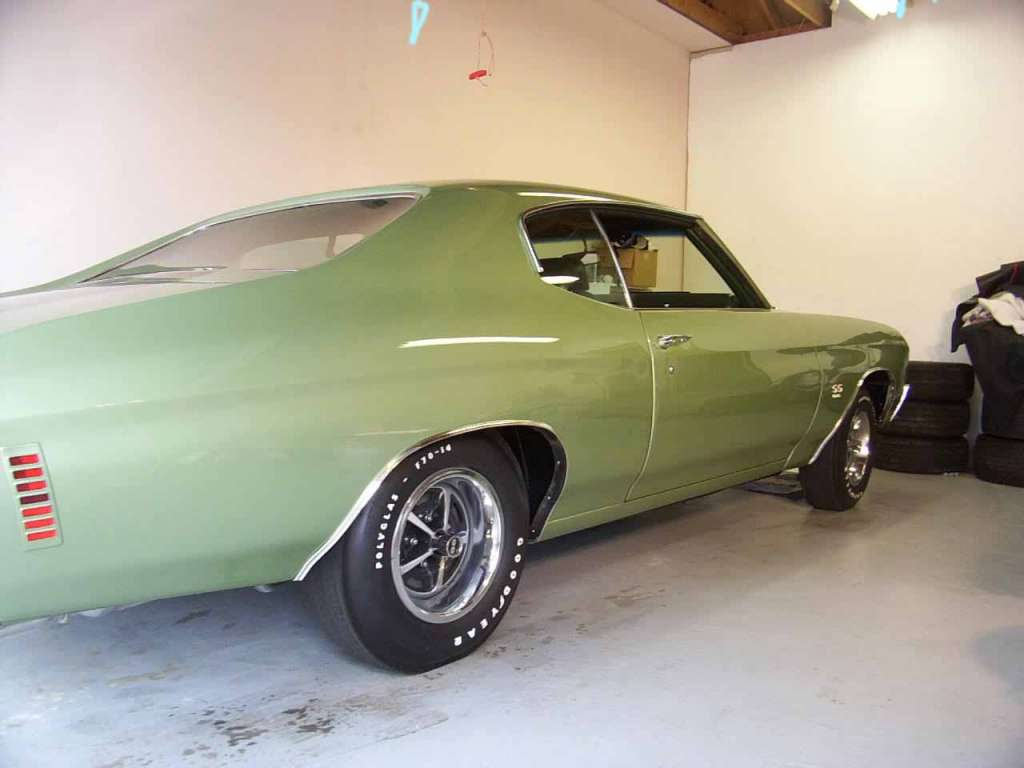

In the 70 Chevy overhaul manual curb height is measured at the front and rear rocker panel.10 inches is the average measurement.Ride height is measured between the top of rear axle tube to bottom of frame rail,not to the snubber.They call for 5 inches at that point.

Car looks good to me! I love that color!

Peter:
Car looks fine. According to your dimensions, rear is right on and front is high. My experience with new restos is that the front is a little high until it settles. I have a 12k mile 70 SS (untouched) that looks like a lowrider compared to my fresh LS6!
Love that frost green!

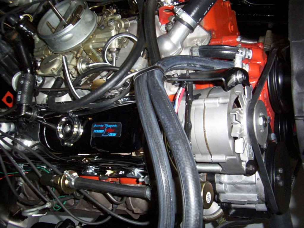

2nd pic

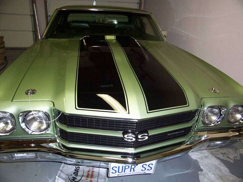

3rd pic
Thanks Mark it worked!
Oh yes the license plates were a present from all my children on My 40 th birth day.
