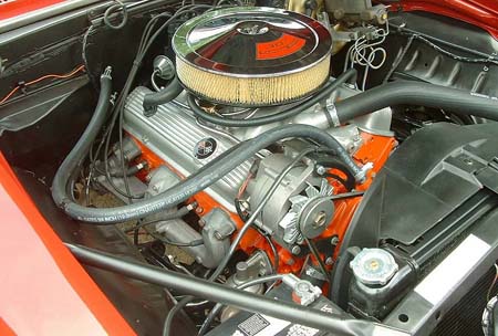

It's hard to tell a lot from the 2 pic's but the smog stuff is missing under the hood and I can't see well enough to see if the manifolds are plumbed and plugged for the smog.
Go over it good I bet they want a lot for it...

Looks like wrong manifolds. It is all about adjusting the price to suit the BUYER.

attaching another engine photo
Here are the numbers i was given by the dealer :
**Numbers Read: Engine Pad: V0925DZ. Build Date: 09E. Trim 713 Paint 52 Styl:69 12437NOR141539 X77 D80. Block Cast# 3970010 / Build date: I20 9, Plus V.I.N.# by Oil Filter. Holley 3923289DZ-List# 4053 / 982 Rear Axle BU0924G , Transmission: P9H19B+ V.I.N., Heads 3927186 / I2349. Intake Manifold 3932472/ I159.
So I assume the above items are dead on anything else is questionable...But it has the exact color combo I want exterior and interior major items are correct and ive been looking since October. I have seen very very few cars with the smog still on them. 90% of the cars i have looked at theres some kind of compromise, things that are not matching ect..."Perfect"Cars are over 50K when you stumble accross that rare car where every single thing on the car is right and its priced right Its either sold by the time you call the guy or its in some color that will trigger my gag reflex everytime i walk into the garage. .
Soooo if one of you gentlman reading this post want to sell me your Perfect Totally Original Z for 40K please email me asap I have the Cash in a brown paper bag waitin for a new owner

Pointing out the missing smog and wrong manifolds was not a put down of the car. Knowing what you are looking at is a great help at bargining time. I was also going to point out the seperation in the center of the grill stiffner in the 1st pic. Again not picking the car apart...
Around here the smog equipment is an expensive item and most Z owners are putting it back on or running the correct manifolds (also expensive) with plugged smog tube bungs.
Good luck - buyer beware...
