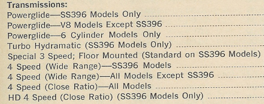

Some more info--this is from a '68 buyers book-- Chevelle--
