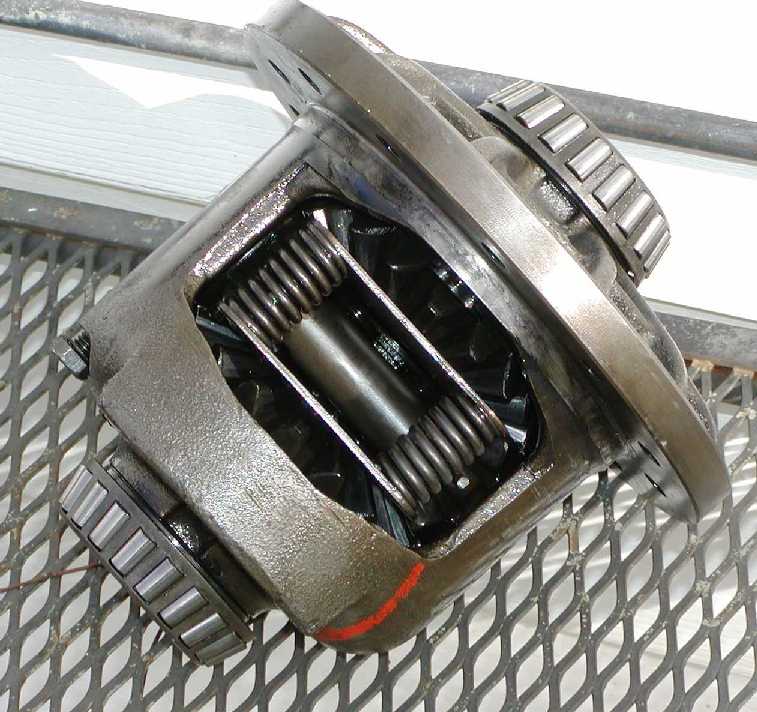

I guess I'm confused. Colvin's book says that a posi with gearing of 3.90:1 and up was an Eaton 4-series, with no mention of anything special for COPO's (p.303). This was the casting that I attached before. Cunneen makes no mention of the carrier guts being special. Attached is a photo of the inside of my carrier. It came out of my BE rear end. It is quite possable that it was swaped out sometime in the past, but I have no history of the car prior to 1989.
Thanks for your help, as I am now as curious as Mark.
Andy
COPO 9561/9737 M40 X11D80

This is the ring gear prior to dissasembly.
Andy

Yes,it is date coded (101)st day. Yes, the Small spiders are still available from GM over the counter. The larger axle spiders are not avaialble nor are the springs or spring plates.

Where is the date code located? Also, could you tell from the pictures that I attached if this was the original carrier? Thanks for your help.
