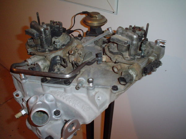

Last one...

The runners on the crossfire manifold were too small due to the EGR being added. And there isn't sufficient material to really enlarge the ports to make the manifold work much better. Cool idea to run 2 TBI units on it, but very limited.
