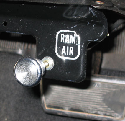

The 68 ram air cars had plastic open hood scoops
The 69 ram air cars were opened or closed by a cable which routed under the dash to a knob....like this
