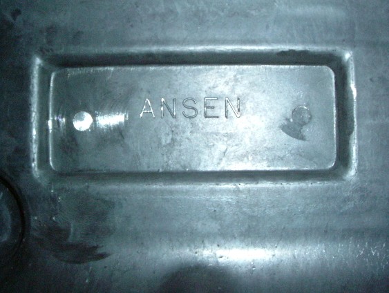

I have a really nice set of finned aluminum Motion Valve covers that do have ANSEN stamped or should i say embossed on the bottom side right under the word motion but they are so nice it's hard to beleive there real is there a way to tell if there fakes ? there is not a single scratch on these things look way to new to think there 30 plus years old...no origin like USA, CHINA, JAPAN, nothing !they were never mounted on an engine by the condition of them .

If you have a small chrome & black (Aprox)1 1/2" x 3 1/2" "Motion" embossed emblem that is not a original part of the valvecover but is glued on with two sided tape then you have a real set.

heres a picture I guess there fakes

heres the black embossed emblem shown

Definitely fake... There are 5-10 sets of these on ebay every week or so...While the overall "look" of the valve cover itself is correct, these type of covers are still produced and easy to get (minus emblems) for less than 100.00. the emblem in the center is someone's homemade rendition, and are much different than original emblems. Hope you didn't get stung too bad on them. Here's an original one for reference. -JB
