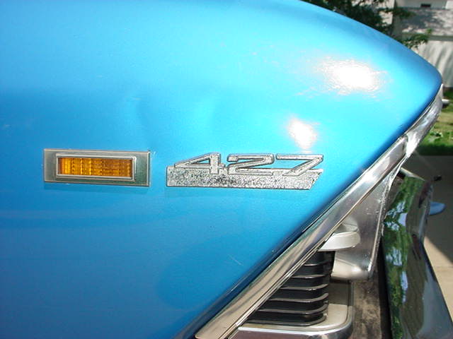

'69 Yenko Chevelle unrestored

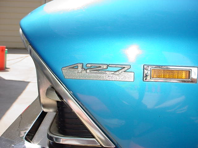

other side
