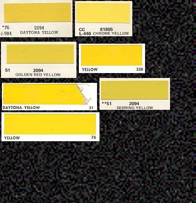

Old 09-06-2002, 07:34 PM
copo9566aa copo9566aa is offline
Location: Montréal, Québec ,Canada Je me souviens
Posts: 1,112
Thanked 3 Times in 3 Posts
Default Re: Rare LS6 - restoration to begin - question...?
Sample of Yellow paint chip 69/70.
Chevrolet
Pontiac
Buick
Oldsmobile
