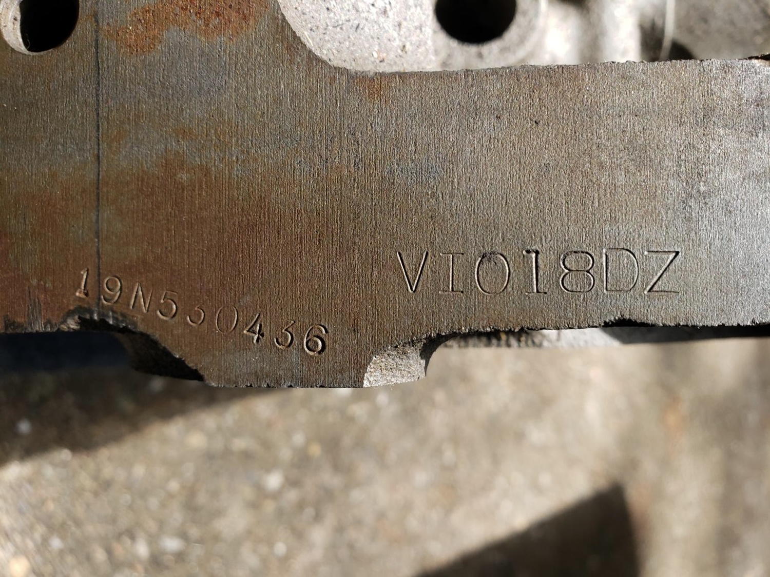

Looks like Engine stamping is 60 cars early w/ N530436 but VIN 124379N530496?

Both Steve Shauger and Kurt Soren have seen the photos and confirmed "mis stamp"
Chris Slawski

Originally Posted by chris slawski View Post
both steve shauger and kurt soren have seen the photos and confirmed "mis stamp"
www.vintagecertification.com

Beautiful pad to use to see broach marks
Bill

Plus as a couple folks have mentioned in discussing the stamps....why would anyone "restamp" the wrong number ��
~ Pete
BTW I know no malice was meant by your observation...just noting odd to see.
