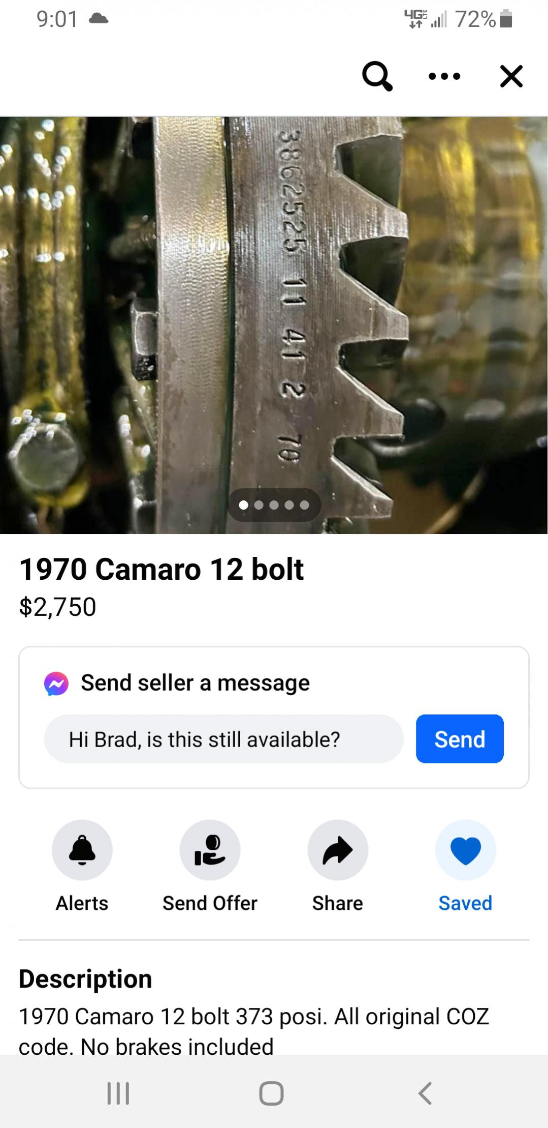

Originally Posted by DAVE H View Post
First off, a huge thank you to all who responded, much appreciated.
I'm going to take a swing at this, as my friend is a "as-is" flipper and it will be for sale. I'm looking at it first hand today. I enjoy restoration projects and reuniting rare parts with appropriate applications. I'll let ya'll know if I'm successful, he's a tough negotiator.
Dave
If he knows what he's got, he'll be asking 10x what he paid for it, but hopefully you can get it...Good luck!
Buddy
1970 Z28 Restored

If he decides to advertise it, I'll let you all know. I won't be buying it.
Dave

Old 04-05-2024, 02:14 PM
DAVE H DAVE H is offline
Join Date: Jan 2022
Posts: 88
Thanks: 83
Thanked 47 Times in 25 Posts
I see it is now listed on marketplace, so just letting you know in case someone is in need. Good luck.
Dave.
