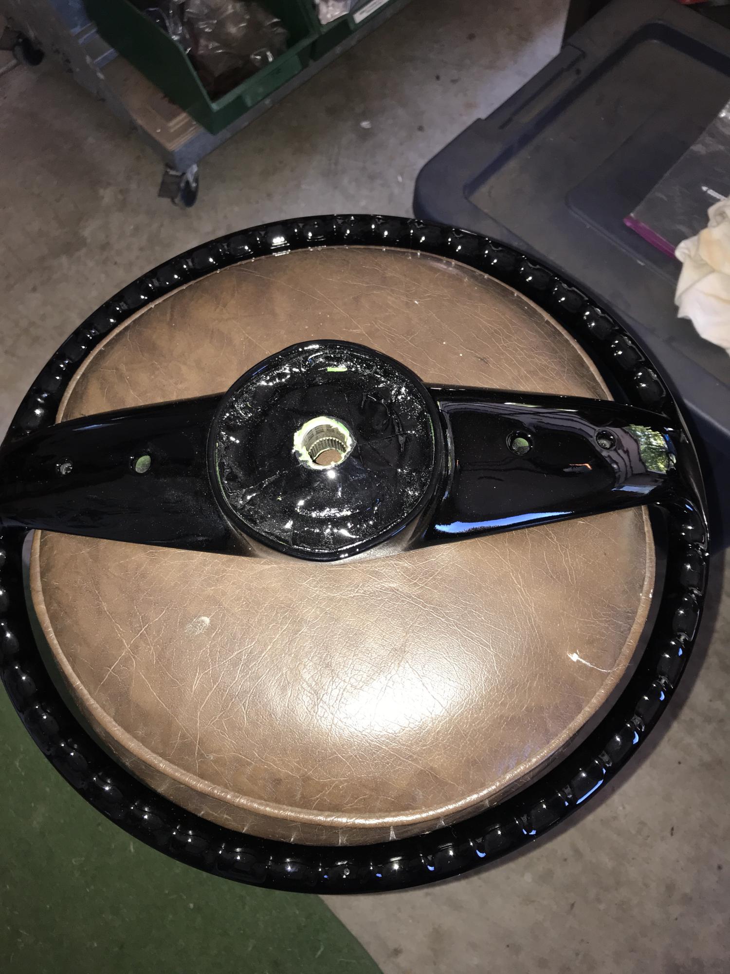

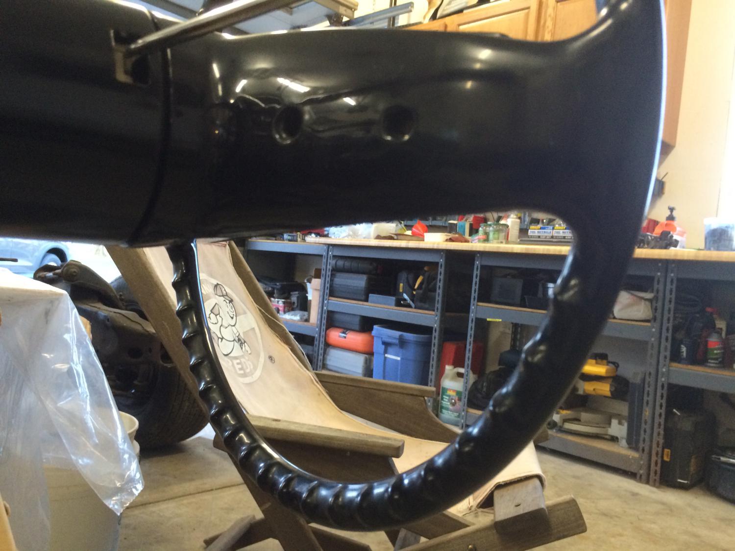

Gloss level. My original wheel and my over-restored, too glossy spare wheel
