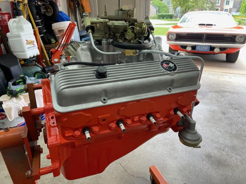

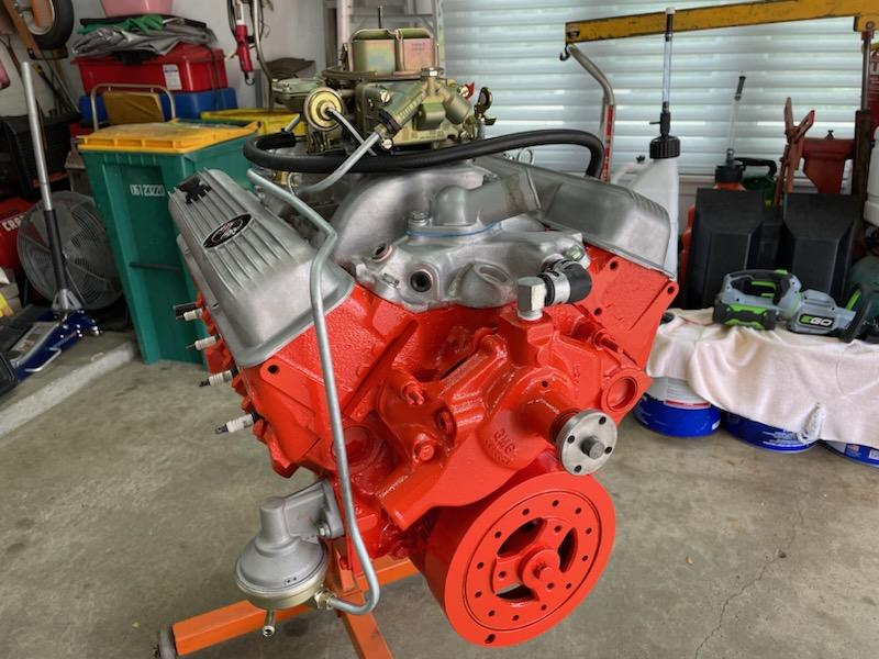

Getting closer to coming home……

69 Z-28 302 Engine. A thing of beauty.

I wonder how much it would lose with stock exhaust manifolds and the Z exhaust?
Out of curiosty why does ithave a shortwater pump and by pass hose?
