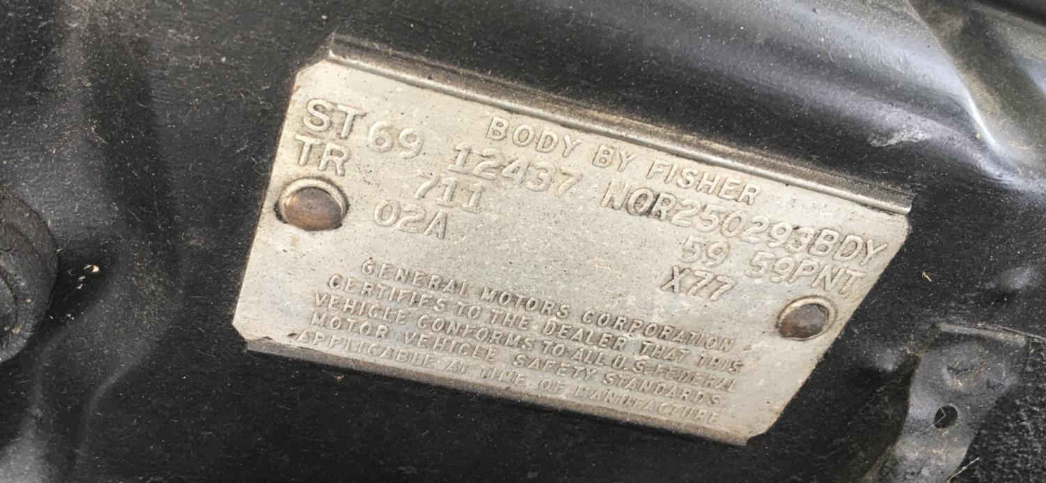

Flip side and not siding that this car is real as I don’t care but there is a local Z and it had a factory A/C box installed by the dealer and still has it today. Wanna say it’s an x77 car too. I’ll look and see if I still have photos. Point is, it can be done if someone really wanted to.
  #18
Old 05-20-2023, 02:24 AM
cook_dw's Avatar
cook_dw cook_dw is offline
Join Date: Oct 2003
Posts: 4,394
Thanks: 674
Thanked 1,740 Times in 664 Posts
Real tag & car. Vin has also never been off.
