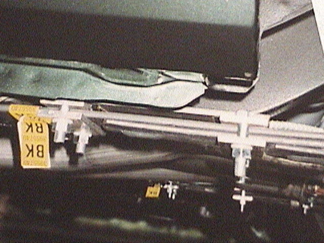

I couldn't find a correctly built front cross over brake line plus I needed to plumb and wire the line lock. So...I built all of those lines myself from stainless steel. Hardline and all fittings are from Earl's. This is the completed line lock plumbing. This is one of those "looks easy enough" tasks, but to get it right takes some time:
This is a photo of one of the ways I figure out brake line bends:
Here's one of the "successful" lines (many aren't so successful!):
Some of the seemingly simple lines can prove challenging. Case-in-point is this feed line to the line lock. It consumed several mistakes to get it done:
I like to use a Weatherpack connector for things like the line lock. If it ever fails, then it's easy to remove and replace.
This is a wee bit amusing when I look back at it. Huge mess (in my old garage) building cutting, annealing, bending, flaring line. I prefer to anneal the hard line prior to flaring, hence the need for the MAP gas. Otherwise the line can crack. In addition, I lap the female side of the flares.
Here's a couple of photos of the finished brake lines:
