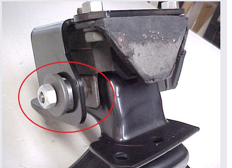

Thanks Lloyd! Im going to ask your unanswered question here from the CRG thread
1. Length of the through bolt
2. Diameter and thickness of the flat washer (it appears to be extra thick)
3. Inside and outside diameters of the bright sleeve that passes through the motor mount stop bracket (best view is the first photo)
my car is a Sept 69 built car

OK, I found them , had to dig through quite a few big totes as they were in storage, sorry for the delay.
Thick washer - 1.380 OD
- .187 thick
Spacer - .875 OD
- .565 thick
Through bolt is - 4.450 bolt length underhead to tip
TR head marking with 6 slashes.
Hope that helps.
Cheers. Mike

Great thanks Mike!! I borrowed link to pic of the mount assembled
