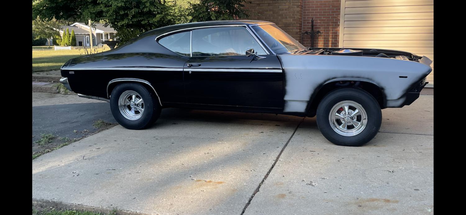

If u blow up my first couple pictures and look real close u can see the tape lines. I’m gonna send them out to Californa this winter to be rechromed.

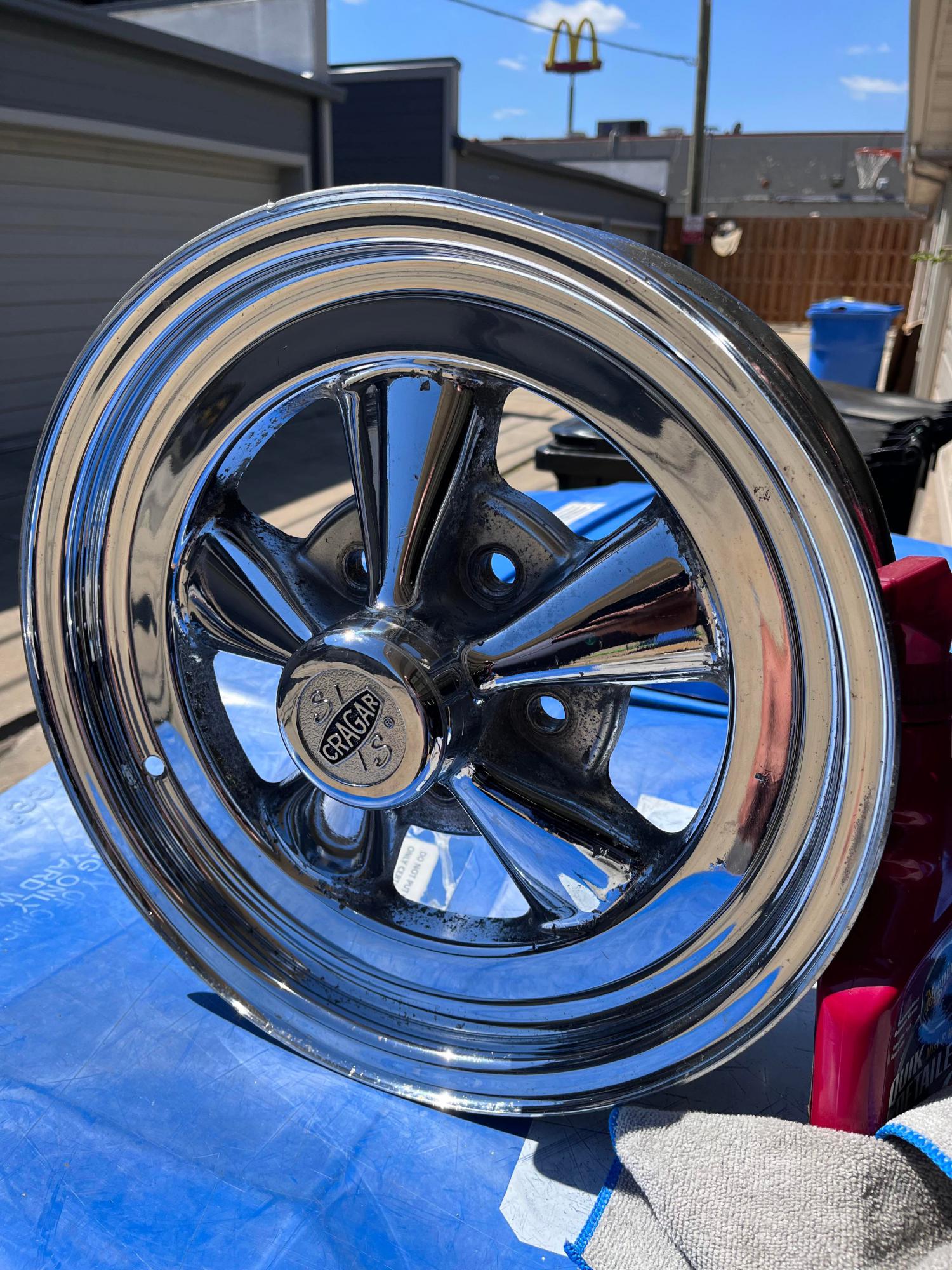

I think this were appropriately priced at $500, what do you guys think? I did not clean all of the inside spoke area, you can kinda tell which ones I did. I just used a spray, didn't not put that much work into them. I'm thinking the pits/flakes would clean up even better.

An older junk yard owner showed me how to make pitting less noticeable. Simply rub the area with a ball of aluminum foil. It will remove some of the tarnish, and some of the aluminum will be transferred to the pit. The aluminum is metallic in color and will help hide the pit. Been using that trick since my first car, and that's a long time.....
