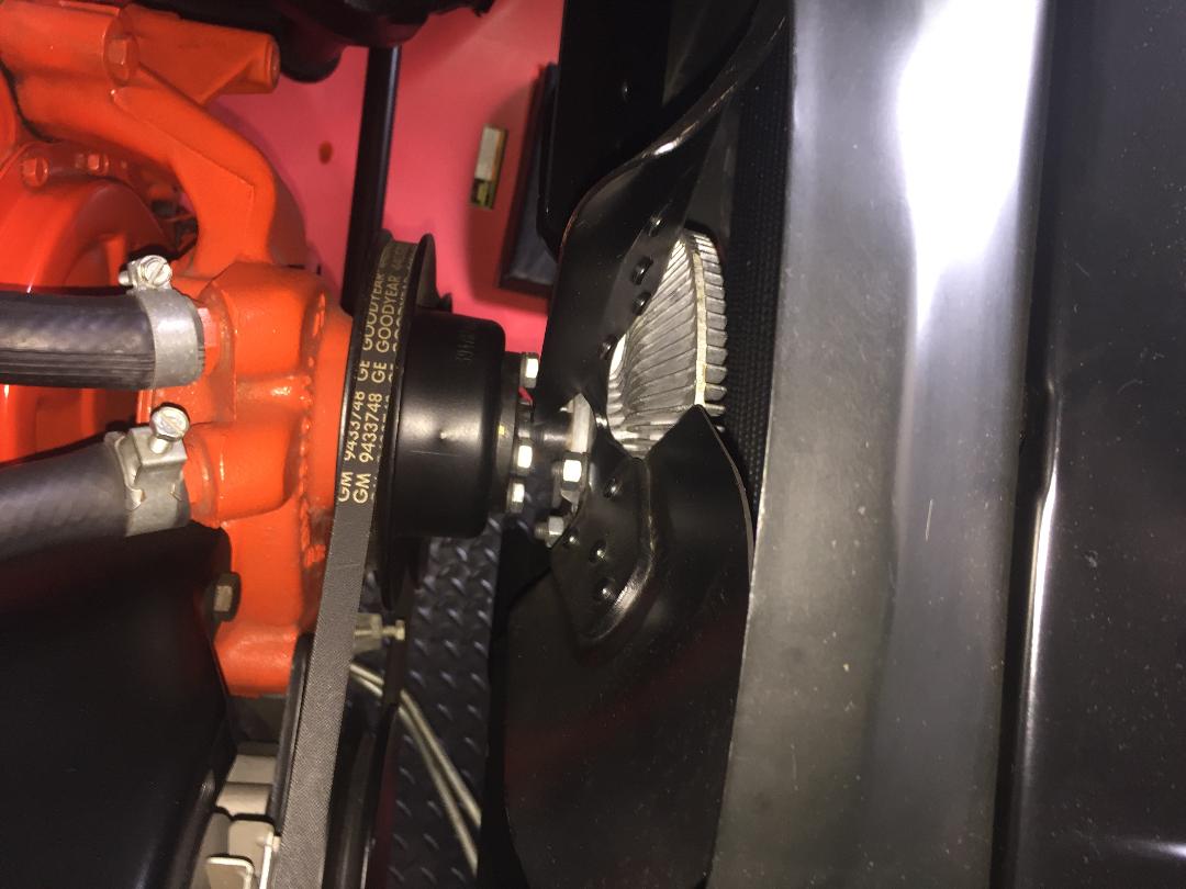

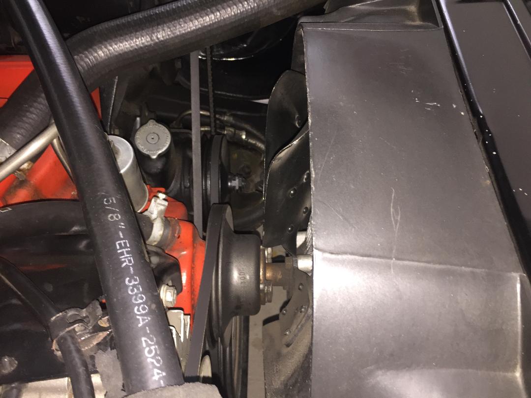

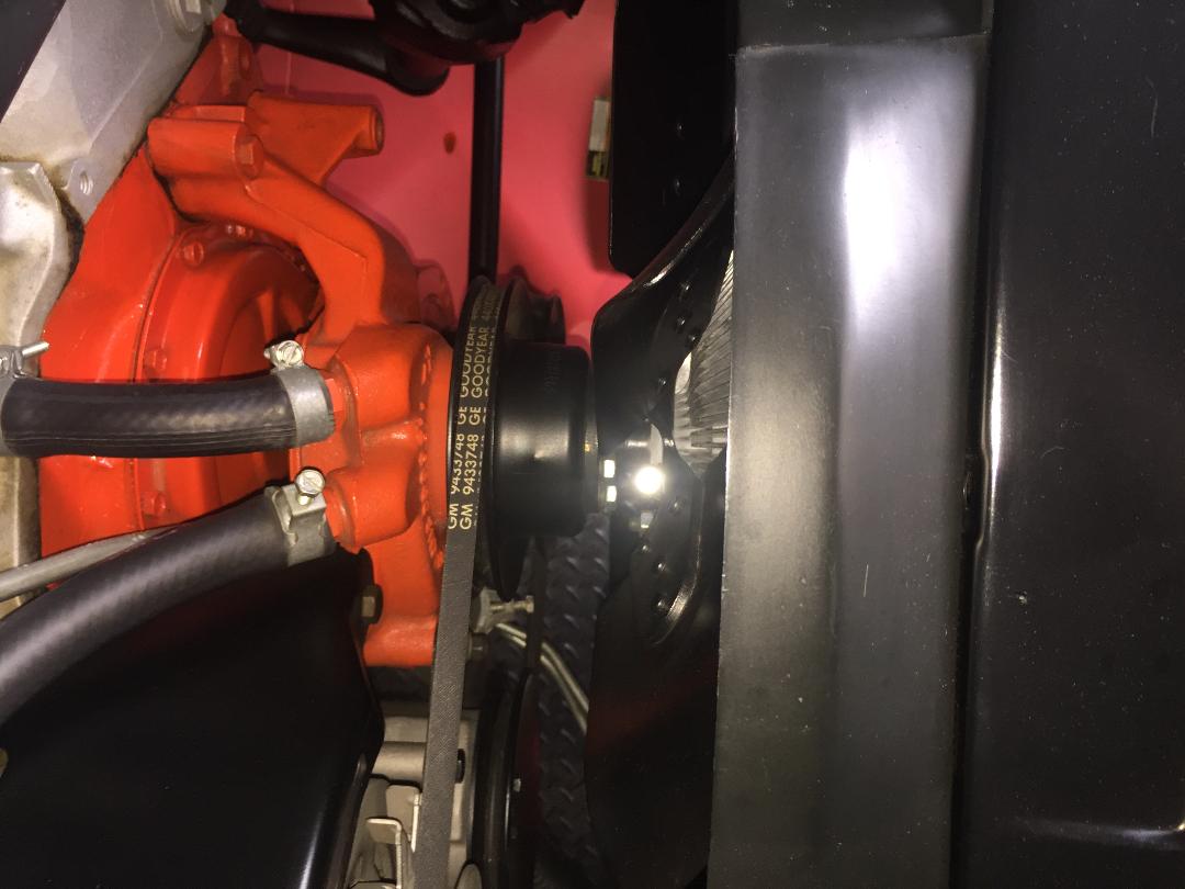

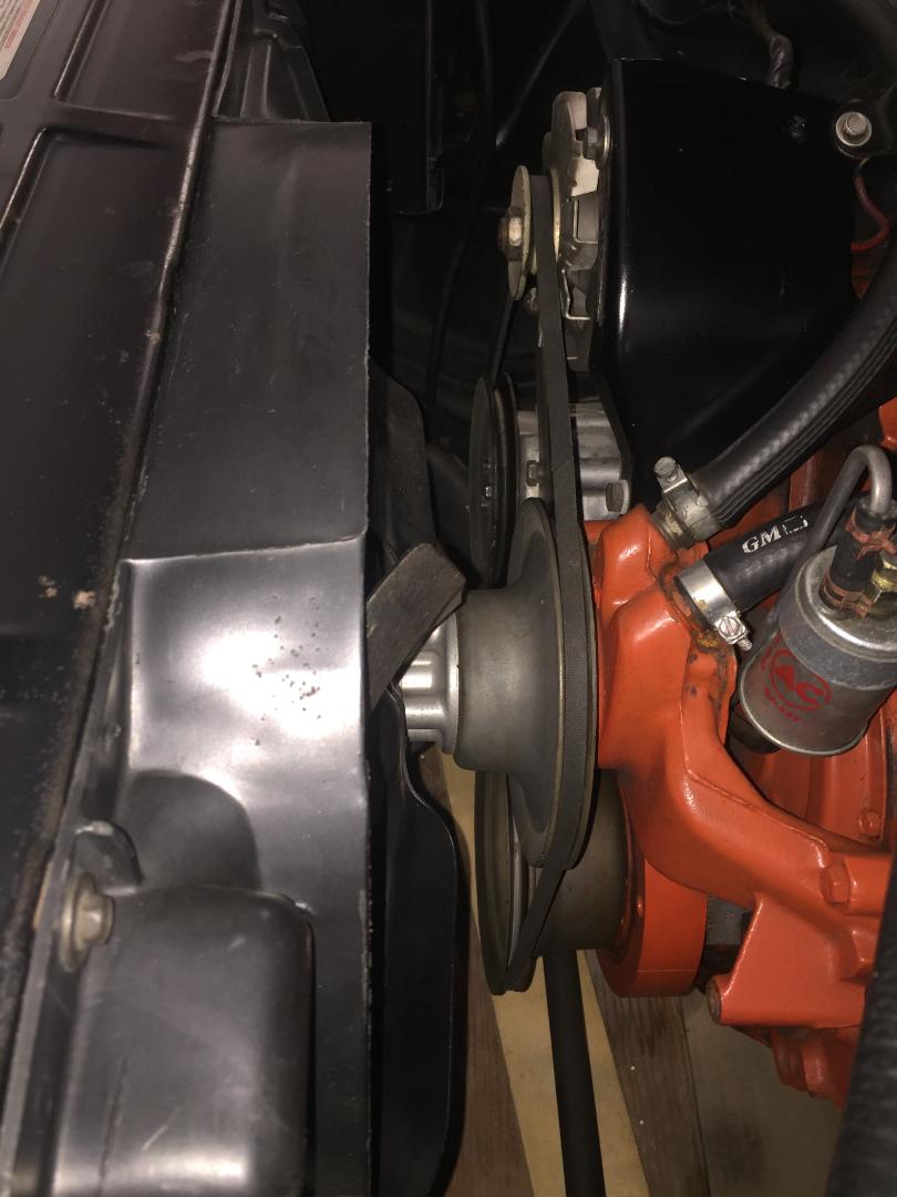

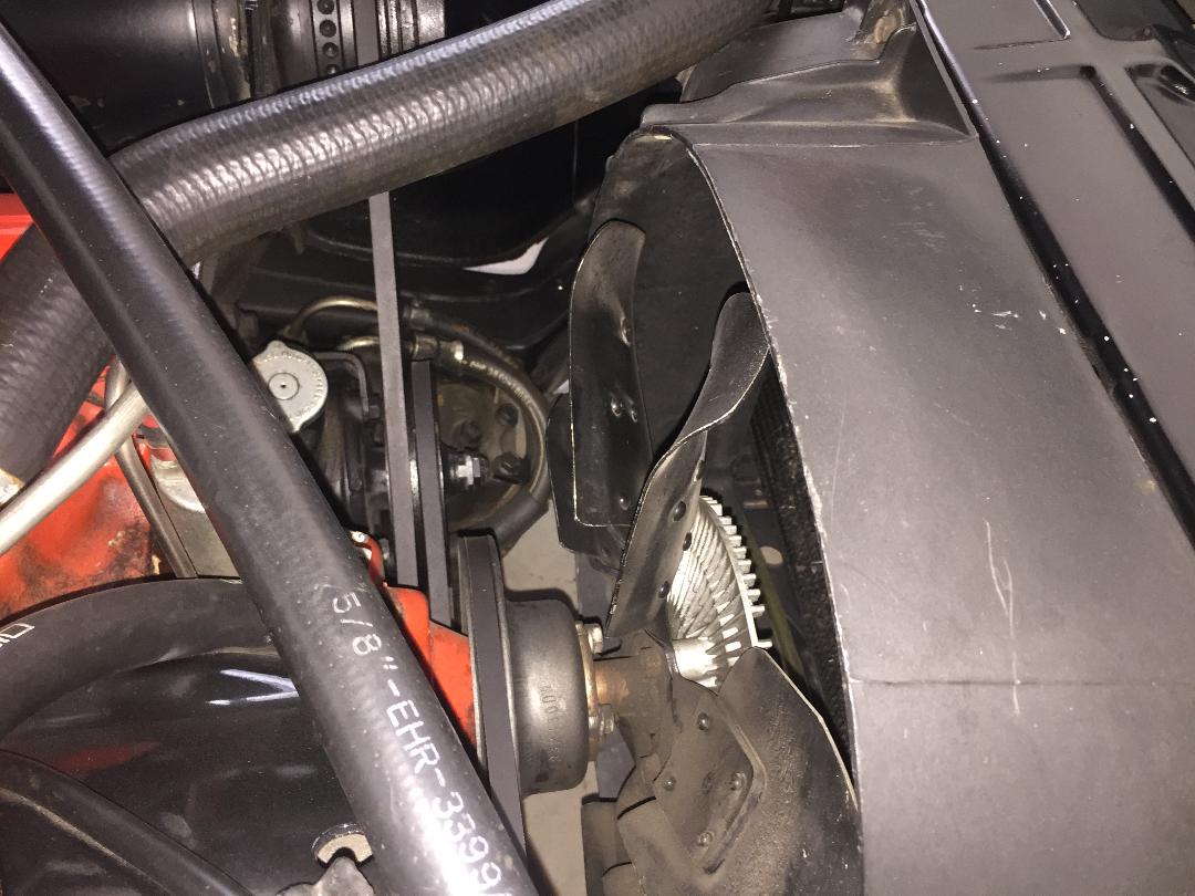

Here's a few pix I just snapped. In order.. I hope.
All these set ups are factory and the fans don't recess into the shrouds all that much. None of these cars have overheating issues. Hope this helps.
1. 1969 396/325 hp fixed pitched fan, no clutch
2. 1969 396/L89 thermostatic fan
3. "
4. 1969 350/300 hp Malibu with factory shroud and theremostatic fan
5. "
PS. I threw the Malibu in for future reference if someone needs it.
