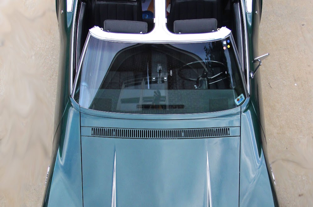

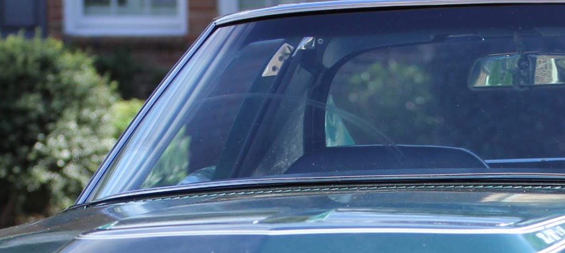

I had a slight gouge in middle of a swath of scratches on the pass side of my original front glass I used a 3" felt pad flat against the surface to polish the entire glass after I used a dremel to SLOWLY smooth the depth of the scratch.
It is now only noticed if you look for it.
