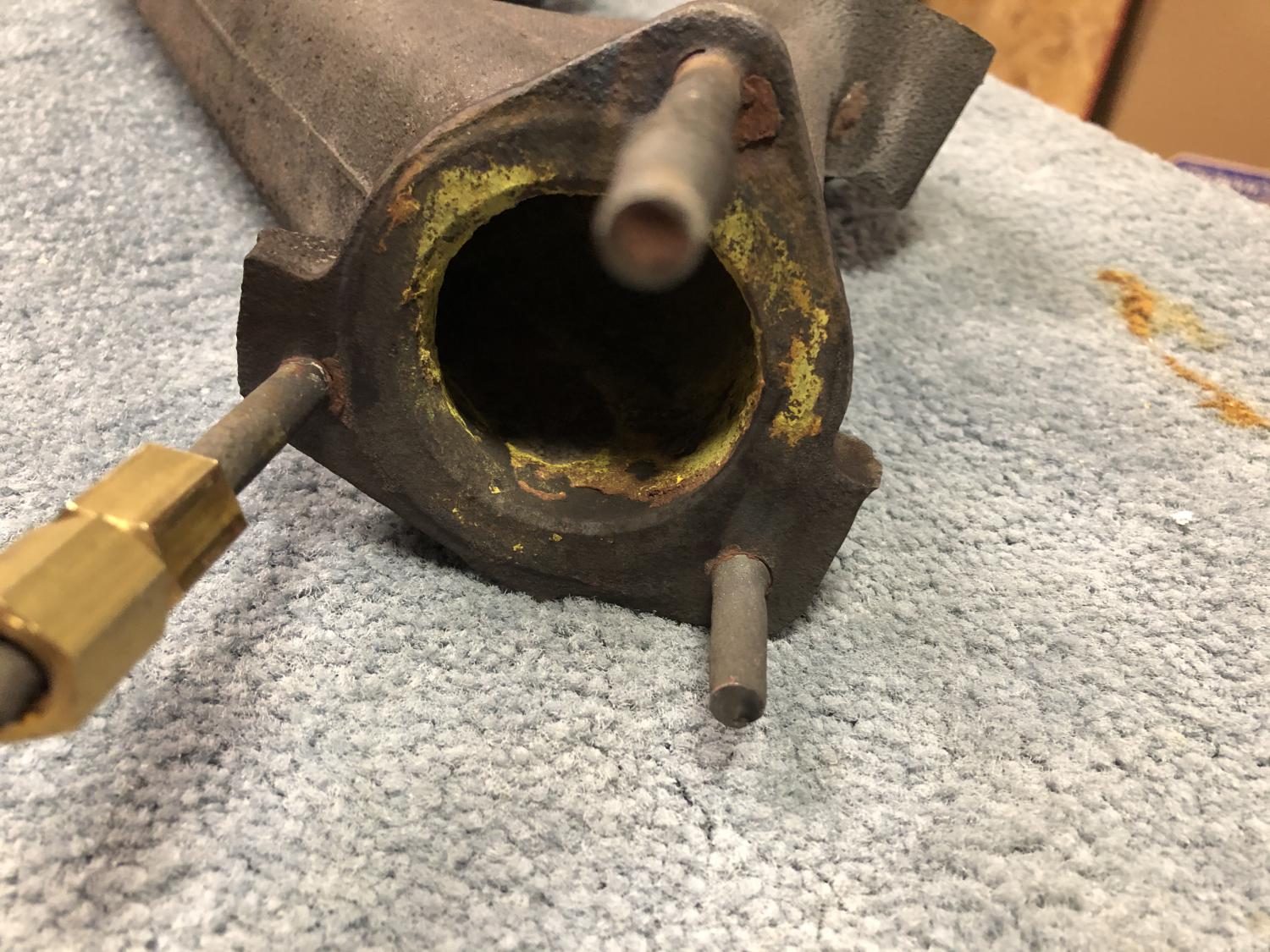

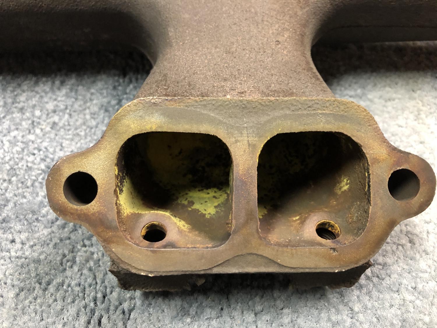

I did make a box and immersed the good manifold in Evaporust. Strange thing was this yellow residue on the inside. Was able to wire brush it off, but it looked strange. Anyone else seen this yellow?

Looks to be Sulphur deposits, likely from octane enhancers used by refineries.
