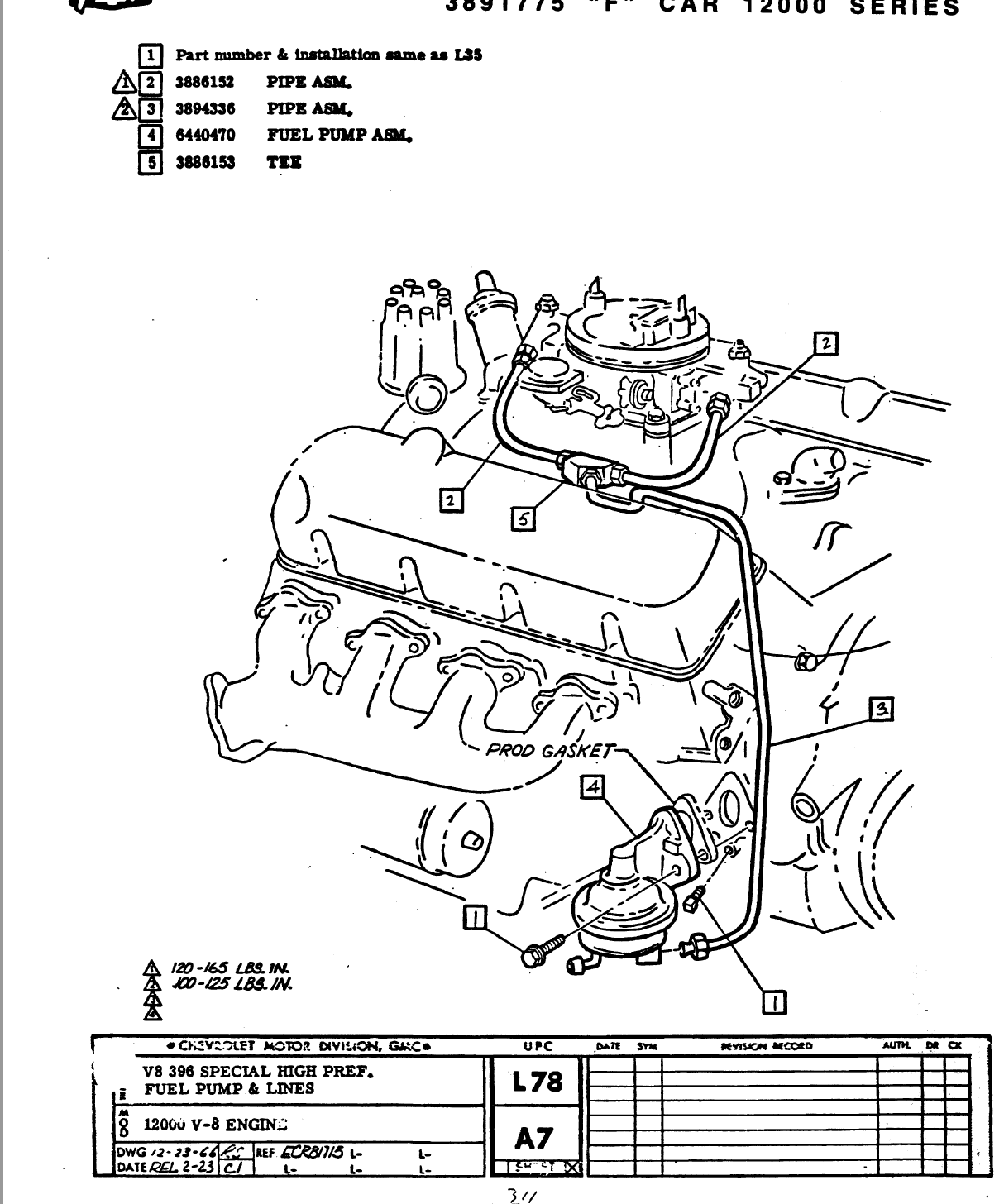

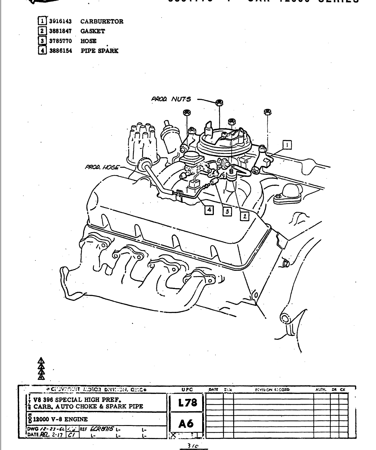

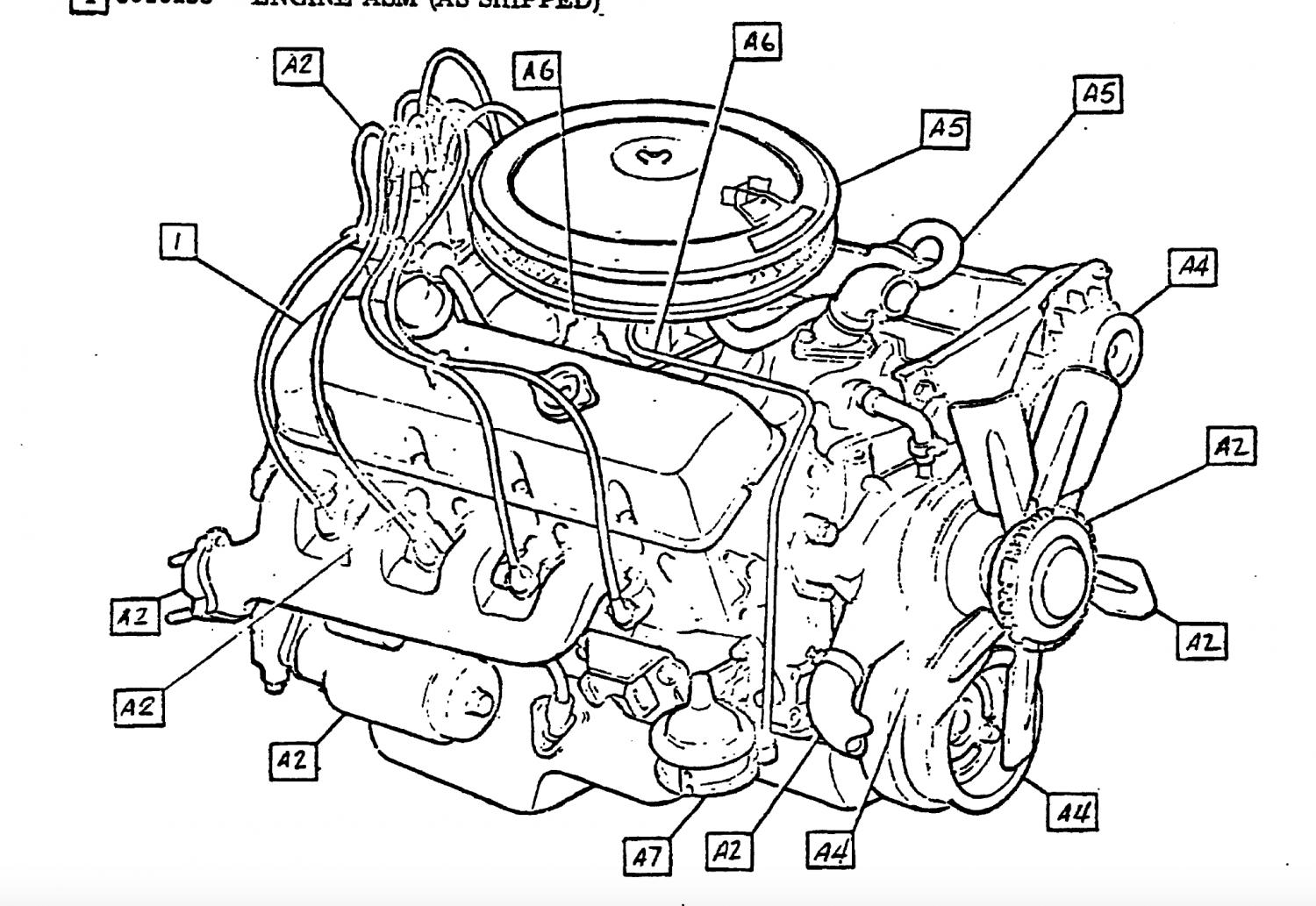

Playing spot the differences is always fun. Here are some screenshots from the assembly manual that may help.
Also I think original valve cover gaskets are silver painted cork?

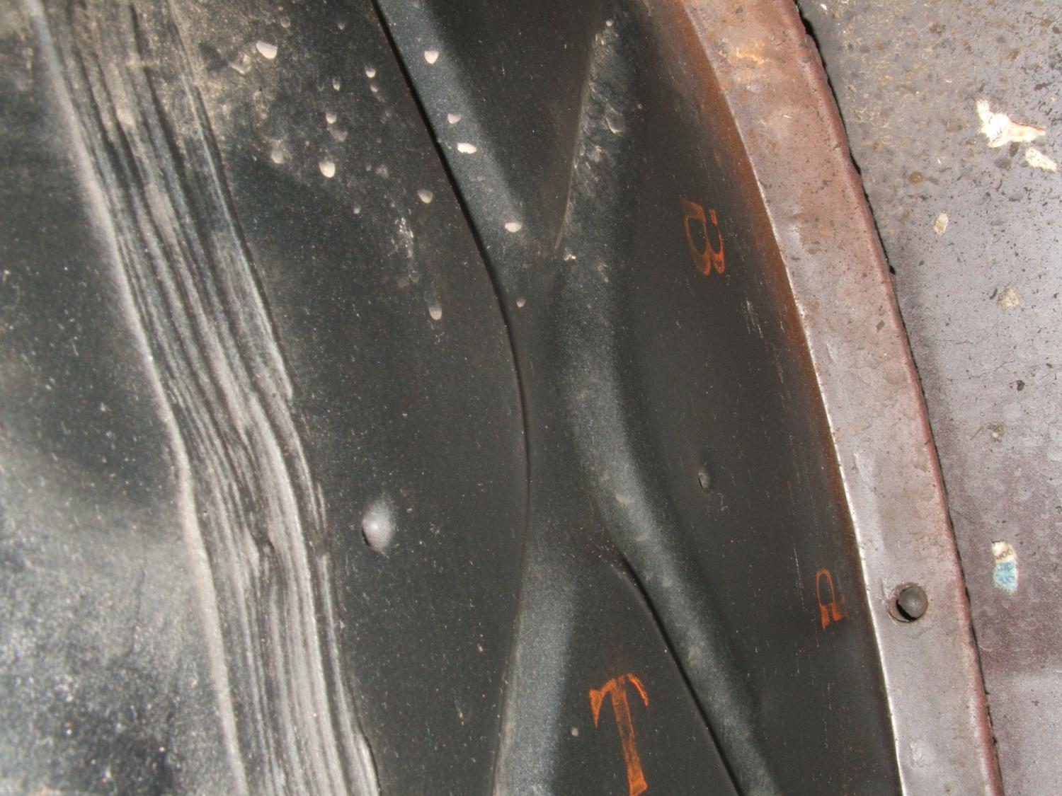

The PTB ink stamps are not visible on '67s and are hidden by the front fenders.

Learning new things about the 4K cars. When I had the fenders off my car for painting I noticed one orange P behind the fender on the right side. That area of the cowl is still original paint on my car. Good information Jon, thanks.

P T B stamps on Gradys Red 67 for re;
