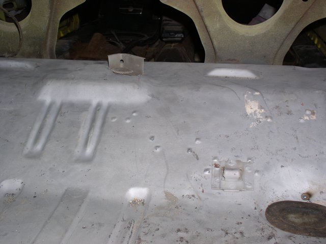

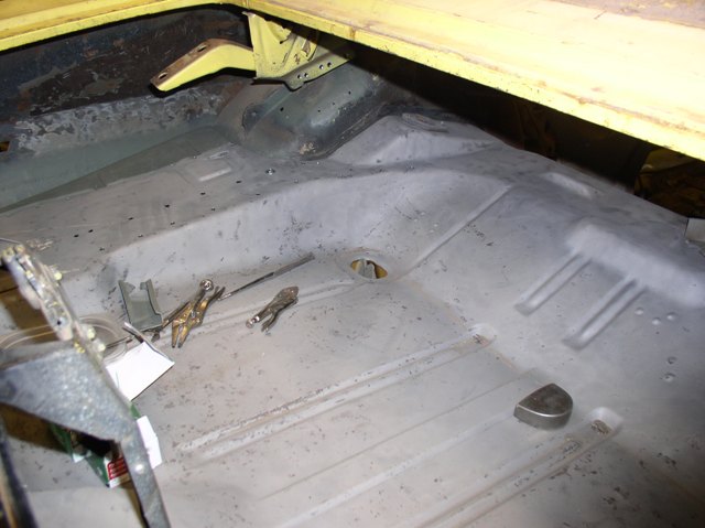

Moving forward to this restoration meant undoing everything I had done the first time around. Out came the power windows. Off came the rally sport. Off came the ZL2 hood. I bought everything new from GM when I bought the hood except the harness. Those were the days. No more JL8. Fortunately I kept all of the parts that I removed knowing I didn't want to lose any of the original pieces.
In November of 2018 I decided I needed to install another trunk floor. The car had 3 things that were not in it's favor, vinyl top, trunk mat & bad gaskets on the lid & lights. All of these lead to leaks which rotted out the trunk floor. After some study I decided an aftermarket floor wasn't what I wanted to use. A guy in Phoenix had the rear clip of a 69 with a nice floor & only wanted 150.00 so off to Phoenix. This is the hard way to do a trunk floor but it was worth the efforts to me. 160+ man hours. There was enough pieces from the rear clip to fix the bottoms of the quarters & the section where the back up lights were...Joe

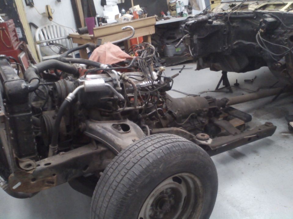

Before we did the trunk floor in Nov 2018, all the front sheet metal was removed in May 2018 & taken to the body shop. I still had the engine & transmission in the car until the trunk floor was done. Now with the subframe assm completely removed it was time to get the body ready for the painters....Joe

Hey Joe,
Great car you have!
I can tell by the way you are going beyond the norm to bring this car back, that you are dedicated to making it really right no matter the cost or time. I applaud you.
The frame and engine shot showing the curved neck radiator is a good educational picture to show the purpose of the curved neck. Most people refer to the curved neck radiator as a COPO radiator, but cannot tell you the purpose of the curved neck. The curved neck radiator was designed for the B/B with A/C. The purpose of the curved neck is to keep the upper radiator hose from rubbing on the A/C compressor belt.
Keep up the good work.
