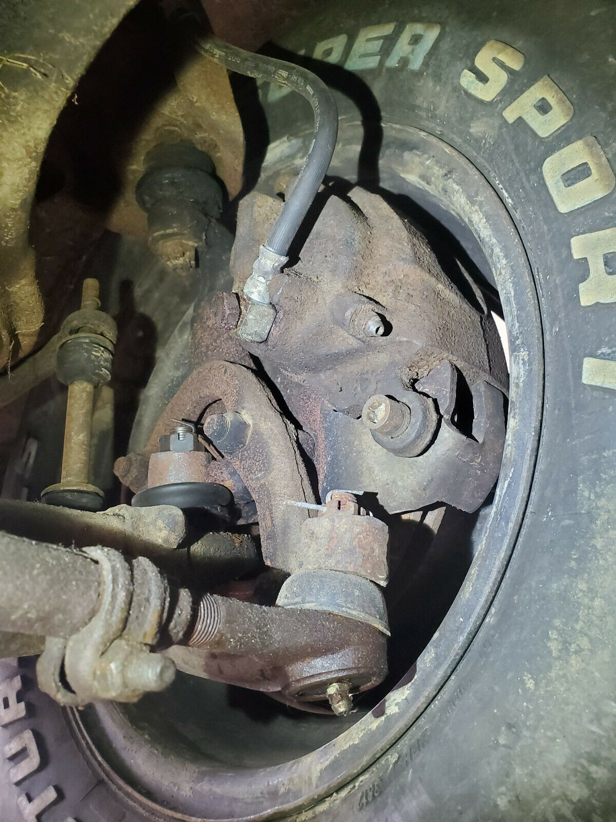

Also, looks like the caliper is on upside down... and been that way a while...

Looks like someone took a torch to the knuckle and/or the control arm to replace that ball joint. Also, that banjo bolt looks like its not sealing the brake hose.
