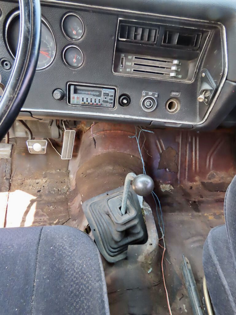

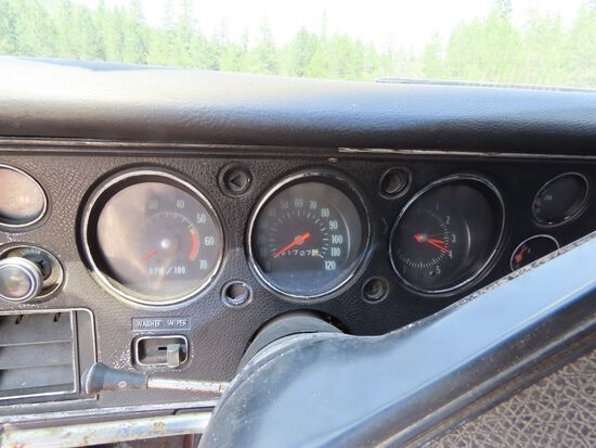

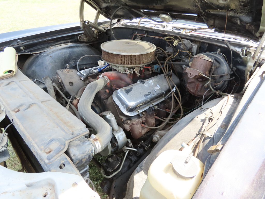

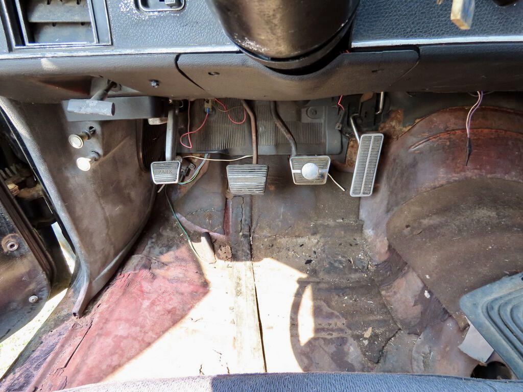

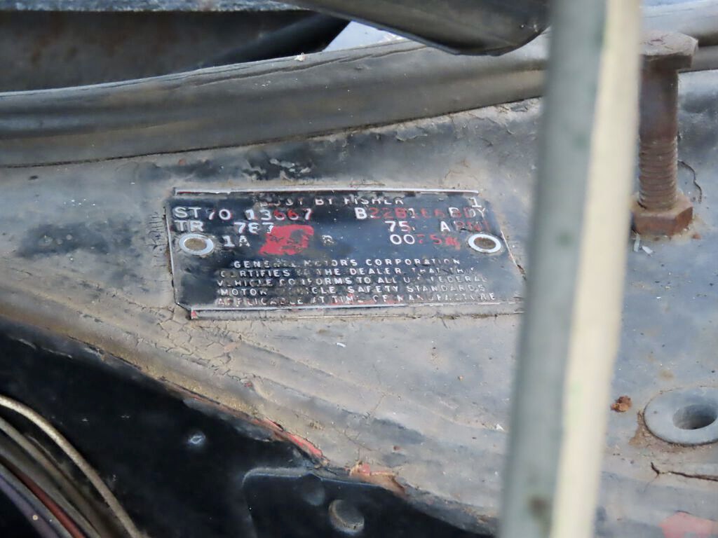

Definitely a 454 clone. The car could be a real L34 4-speed convertible, but without a build sheet anything is possible. I’m basing it on the fact that it has a big block steering shaft, a 5500 rpm redline tach, and original 4-speed pedals & hump (for bench seat or non console application). The trim tag shows it was an original cranberry red car with white convertible top and red vinyl bench seat interior. The car is an 11A which makes it too early to be a 454 car, especially with an M22. There is also a tell on that trim tag that shows the car didn’t come with factory stripes so most likely the ZL2 hood is also an add-on.

Love the stereo.That thing was state of the art back in the day.

----Whats up with the remote mirror control location on the dash???.....Bill S
----Went back to the pics and can see the passenger side mirror, so it must be a remote mirror added on the pass side!
