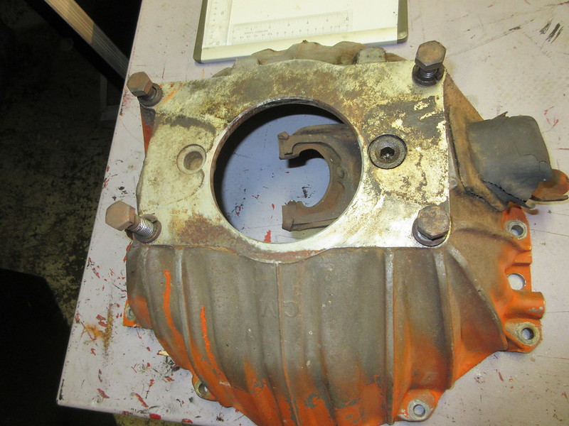

While on the topic of bell housings, a couple of questions those in the know might chime in with. When fogging the edges of the bell GM orange:
  • Do the bolts get painted as well, or did they stay natural?
  • Is it only the mid and top section that got fogged? From the bolts up?
  • Lower inspection cover and bolts black or orange?
I have seen some people do the bell all around the flange including the lower section, but I cannot see that to be correct on the bottom side? I could see it being fogged just where it meets up with the block and upwards but thought I better ask to be sure.
Thanks in advance for any factory paint advice on the bell.

Since the bell housing was on the engine when it left the engine assm plant, I would think the bolts had paint on them.
As to how much paint I would think would be determined by who was doing the painting at that first time
These are my logic. Not sure about the last part...Joe

Bell bolts get painted as well as overspray on fork (not boot, it was off ) A lot of bellhousings had varying degrees of paint, I think typical was about 2"-3" but I think there have been examples of almost complete coverage on original cars, and Yes the lower inspection cover and bolts were painted also. Lower inspection cover is unique, it should have NO ears on it to clip on oil pan, and beading patterns are different than the current GM replacements.
Corvette Central makes a nice reproduction, they are exact.
https://www.corvettecentral.com/c3-6...pection-532118

69 Z28 original bellhousing paint

----Love the runs! Gotta do that...….Bill S
