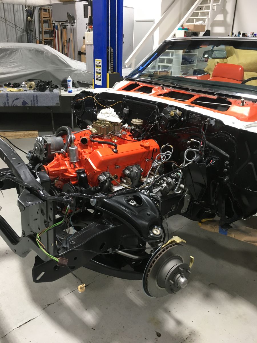

Making some good progress, hoping to have it finished up this weekend

Coil bracket had bright plating; need correct PCV and hose. Dipstick and tube should be natural steel. LH wire separator bracket should be orange. Upper control arms were painted as an assembly [less ball joint] so washers should be black. Sway bar and brackets should be black. Cowl plenum should be orange.

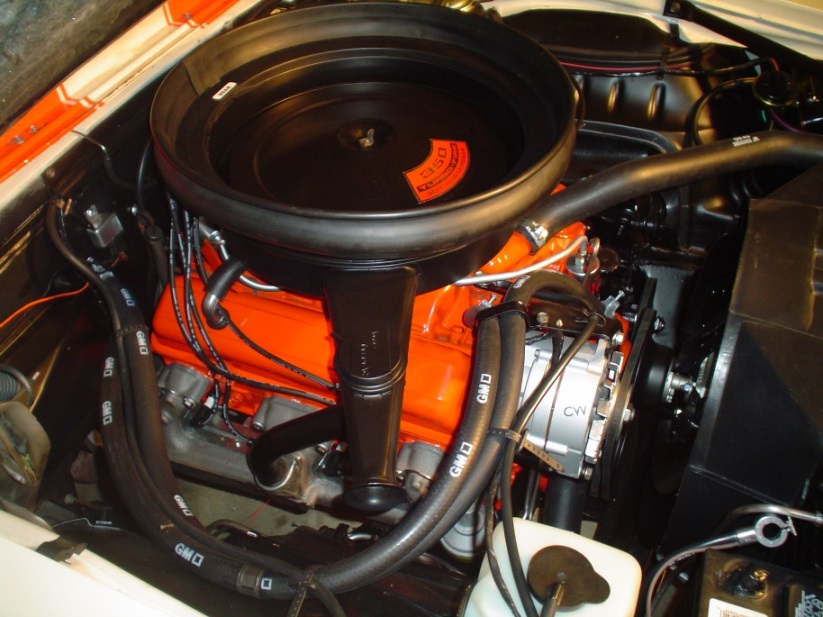

You are on the right track. If you want images of my Z-11 EC for comparison let me know and I will get them up.
Images are a time saver for sure.

Here is my NOR Z-11 HB 350/300. It is not 100% factory correct however it is perfect for a driver and just about any grass show you want to go to.
Hope this helps.

Overhead

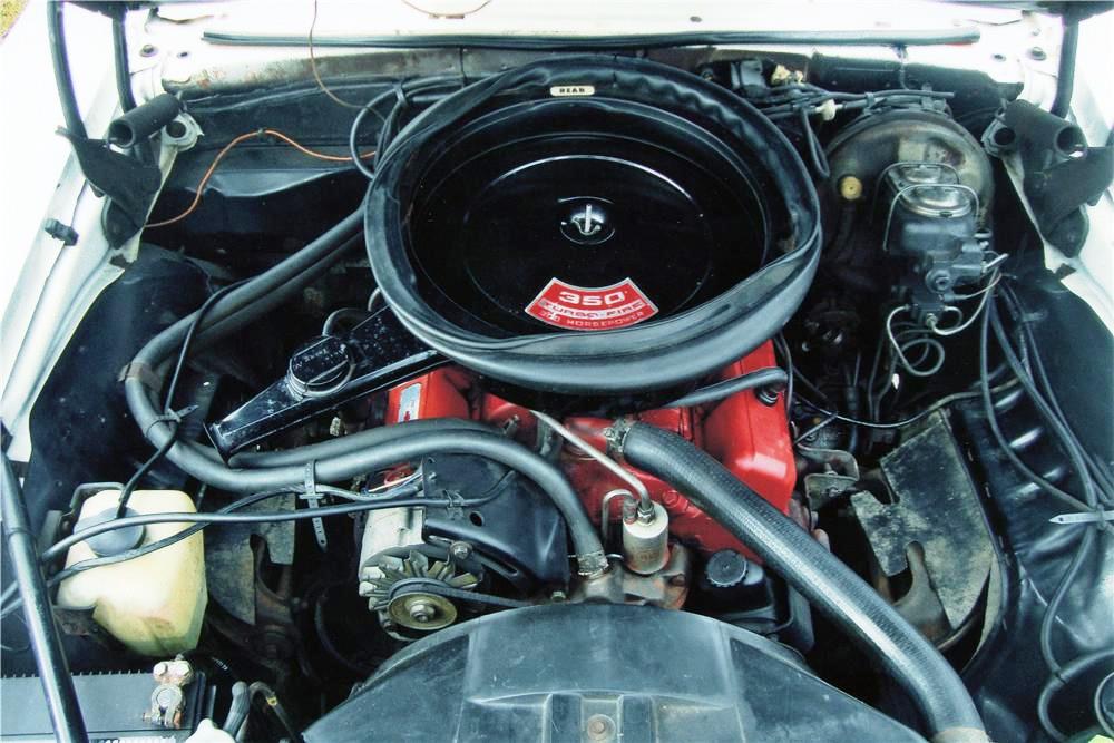

Survivor example with over spray engine stop lift recall hold down- and patina.
