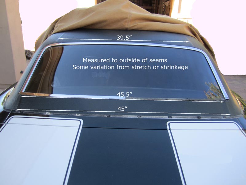

Thanks for that response Fred. I will call again. Did it have the correct seam widths also because what they were telling & what I saw on a friends car were too narrow on the skirt?. I must've looked at every Camaro at MCACN to make sure what I was seeing was correct.
Here is a picture of a known correct original top ..Thank you, Joe

Thank you for the picture and measurements
Question - Measurements- inside- inside or CL-CL?

I had to blow it up but it's odd. It appears to be outside to outside on the top part but inside to outside on the skirt or center to center. I didn't do this picture. It was sent to me years ago. Let me know what you have please. thank you, Joe

After examining the picture I posted & other pictures I have, it looks like the outside of the seam on the skirt is or probably was supposed to be even with the inside edge of the back window stainless...Joe

Update. The parchment from Kee is now off white & is too bright compared to the original sample in the dealer album. Both Kee & SMS are heavier on the grain but SMS parchment matches the color in the dealer album. I hate dealing with SMS but I guess I have to. I hope they will be able to use the measurements I've provided in the previous picture...Joe
