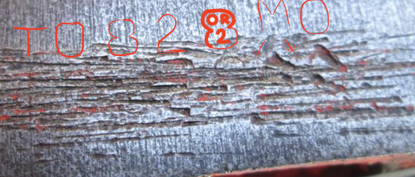

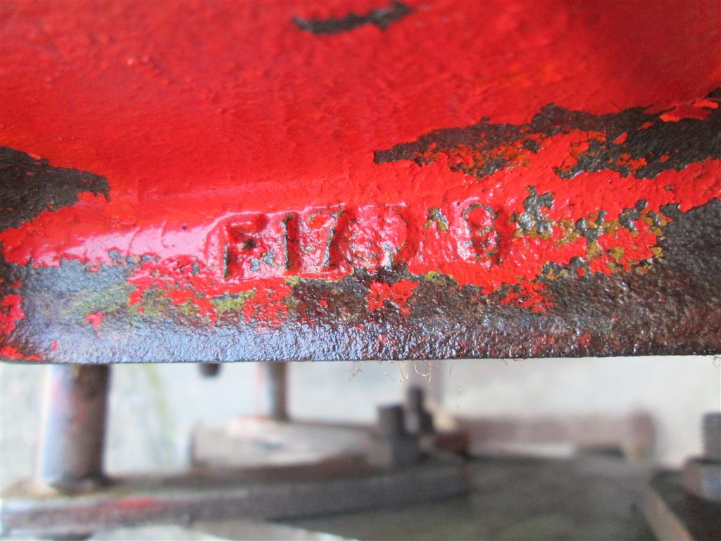

Willing to bet money on it. Top tips of the M are visible, lower half of O is obvious to me.
I ain't nobody, dork.

And I'm gonna go with T0 ? 28 MO for the whole stamp.

You guys are probably right about the pad stamp being mutilated for unpure reasons but who really knows. Its really a shame since the rest of the engine is awesome. It is still standard bore and looks like it will stay that way. The crank is even still STD/STD. It was greased up and stashed away 30 years ago.

I don't plan to try to find the car. If I was going to do that, I would not have posted the VIN. I just thought I would check before marketing the block. As far as the suffix code goes, someone mangled it long ago for unknown reasons. That is why I never thought to look for a VIN by the oil filter. The chances of it being a COPO block is slim compared to other applications. When I was taking pictures, I realized it was not a CE block since there was no assembly date on the starter mounting pad. Then I thought it was strange there was no VIN on the pad and looked at the alternate oil filter location. Here is the pad:
Thanks again,
Jason

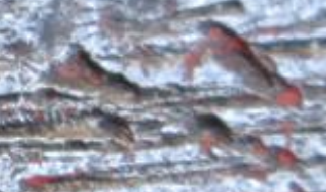

For those with questionable stamp's Jason's closeup pics show outstanding broaching marks!

I own 680415....I agree with the 8-22 assembly date.
Top of it looks like an 8 but I can see a horizontal stroke at bottom that could be bottom 2 , I will defer to your superior knowledge of dates of these copo blocks. I pointed out the tips of the M with red arrows.

Yep, T0828M*. That date makes the most sense for that VIN.
