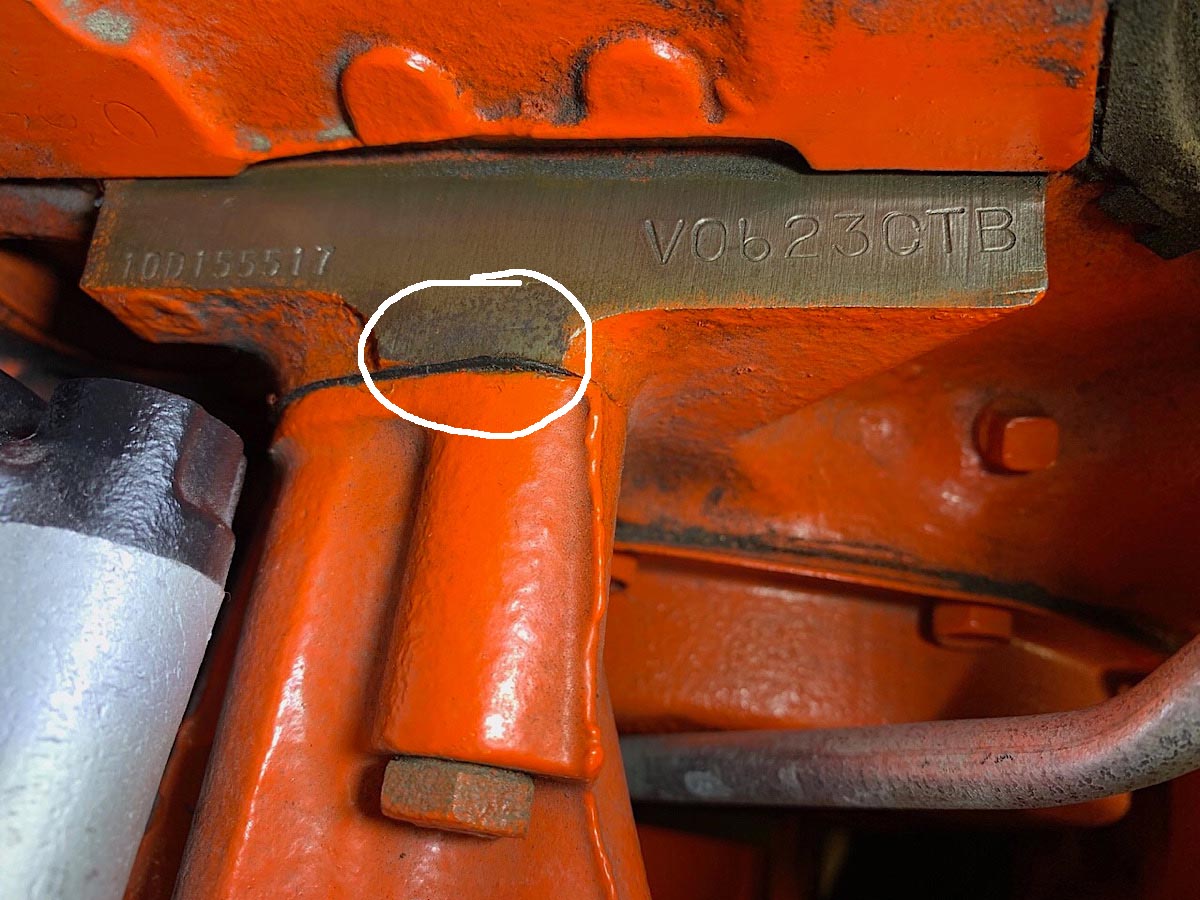

Doesn't resemble original stamps in my database

I had an original 70z engine and the VIN stamping was down by the filter. NOR car stamped V0518CTB. This stamping above has some issues. Isnt D for Doraville?? Plant that made the big cars. Definately is not a Camaro VIN. Whats the casting number on the back of the engine?

D was indeed used for Doraville,but that CTB code was used for a 1972 Impala series with a 240HP/402cid.
Agreed

But in 1970 it was a 350 LT1 4-spd |
OK I will clarify the stamping. It is completely incorrect from fonts, codes & broach marks.

Another heavily belt sanded deck. Not even close to original, like noted.

there are some very obvious signs here

Doesn't this area appear to show a lack of machining as though it were not level with the rest of the block?
Also agree the broach marks nor the assembly stamp are not at all typical.
