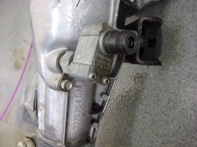

Originally Posted by cdn454LS6 View Post
I found one guy selling a reducer
and claiming it's for LS6 410 rear
666F V8
.8241C
maybe mine is for 456 rear ?
My 1974 z/28 4 speed has that same reducer on it. Its definately the original reducer. Im sure I have 3.73 rear
Here are pics:
