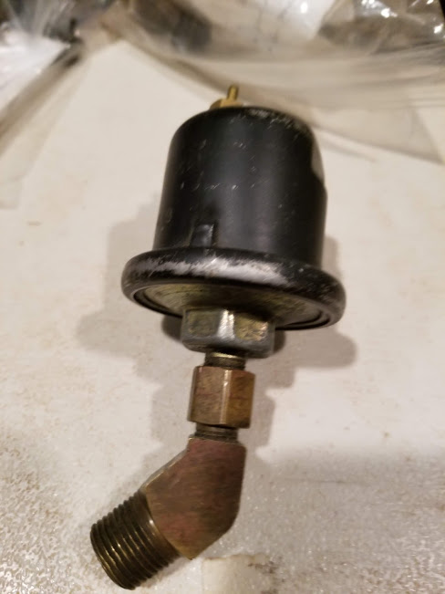

Couple of quick questions if anyone can help. There is a new engine wiring harness on the car but the lead for the oil pressure sensor has a round female end and the pressure sensor itself has a male blade. Pictures I see on line of the sensor for a car with gauges shows a sensor with a male blade like I have.
Also should there be a 45 degree brass fitting between the engine block and the pressure sensor.
Hopefully someone has more knowledge or a better memory than I do.

The round end for the oil sensor is correct. Oil sensors with the flat terminal like you have are not correct. You should also have the 45 degree brass fitting that the sending unit screws into. I don't have pictures to show you but I'm sure someone here can come up with them.

Found this picture, courtesy of Rick Nelson. This is what you should have if your Chevelle has the factory gauge package.
Actually that photo is courtesy of Dan Vasic if I recall correctly and I just used it as a sample. Can't remember for sure as my brain was quite foggy back then.

OK. Right now it only has the large round sensor screwed into the block. I can get the other parts, but they might be current reproduction pieces.
But the sensor I have, and the ones I have seen for sell, all have the blade terminal. I will fashion an adapter to connect the wire and sensor.
